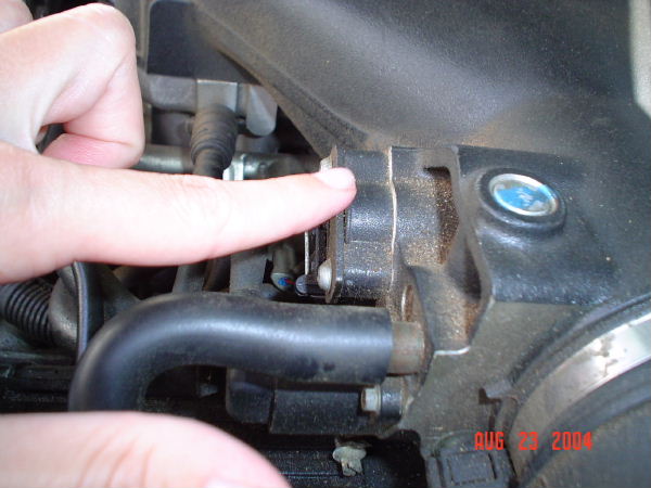

Here is a quick pic of my 1998 D1 (4.0 50D Engine). As Serg pointed out there is a world of difference: My finger points to where I believe my problem lies.

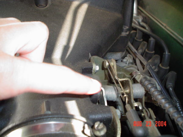

And here 1998 LR D1 versus Jason's 1995 3.9 D1:

Two things i still dont get - need to look in rave CD i sppse.
1) On second pic - why is that small hoose between your fingers aint got clamps on it, and why it points to rocker s cover? Is it connected right to it ? On 3.9L it goes to plactic T-piece that joins together flame catcher hoose and (not anymore for me!) crankcase breather filter on the left.
2) what you pointing at in first picture? And how is your stepper motor (IAC) btw?
3) no more pink nail polish? :)
Moose
Mar 12, 2004
1,082
(1) I believe (need to check workshop manual when I get home) that's a breather tube, Sergei.
(2) Melissa, does that mean you don't want my lights? They'll go on a Jeep too, you know...
Sergei
Mar 16, 2004
827
Why the heck they put in straight tube there? It will suck in them oil vapors a lot.. On D1 there is at least crappy filter in between.
You most likely right Andy, it just kills me as weird tech solution.. :)

I know on my '97 I found both Breather hoses were just about completely rotted out...Replaced them. Of course I did notice a little better Idle, but that was about it.
I regularly lube the linkage for the throttle and clean the trottle body often as well.
Of course I am not sure that any of this will help with starting issues.
Normally wouldn't the TPS or the Stepper motor be more for Idle issues as well?

You right stepper motor is indeedy more of idle device, but i just sort of got IAC idea from looking at picture. Dunno why.
I still think that its ignition issue more than anything else in Melissa's case, but then i am way worse than backyard mechanic :)

My 96 D1 has that tube as well -- and the more I think about it the more I think it is a breather tube of some sort. To equalize pressure between valves (where "bottom" end of tube hits engine) and combustion? I'm not sure, but I thought I saw that somewhere....
