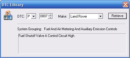

I was also getting 1100 and I believe 0007, none of which show up anywhere in any code list I've seen. But I'm also getting 0171 and 0174 consistently. Thanks for the digits - wanted to make sure I'm on the same page with the O2 thing.

Couldn't find a 1100, but the 0007 is: (I would start looking at the MAF)
