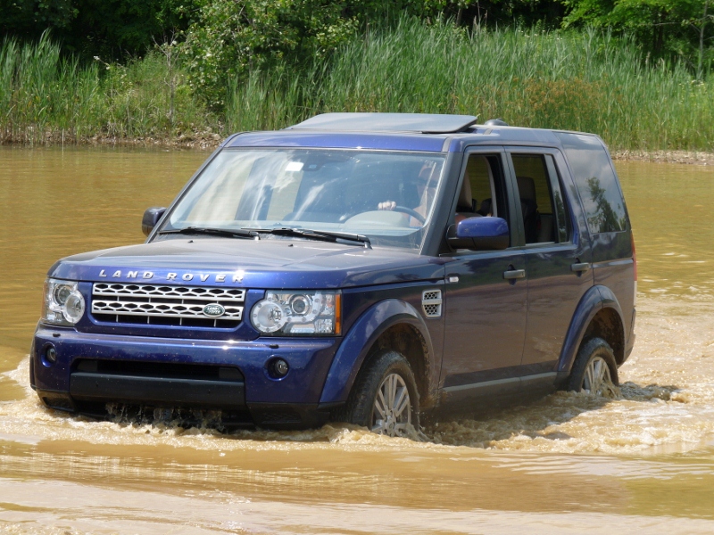

The RS sliders were what I was looking at. I had cruised the LR3 forums, and it was mentioned that you lose some body/frame isolation with these sliders. I've heard that the LR4 was supposed to be quieter than the LR3, so I'm hoping that there won't be too much difference. Thanks to all for their input!
xray132
Feb 2, 2011
32
Place dynamat on top of your RS slider under the compressor area before you mount them up. It stops the noise from resonating back off the steel plate. I have it on my LR3 and I think it is as quiet as it was before the sliders.
93
Hey erdoc38,
Very nice picture - great looking LR4! I still have yet to do that in my LR4, but maybe someday. Though, sometimes I drive over the curb on my 4 mile drive to work - LOL!
