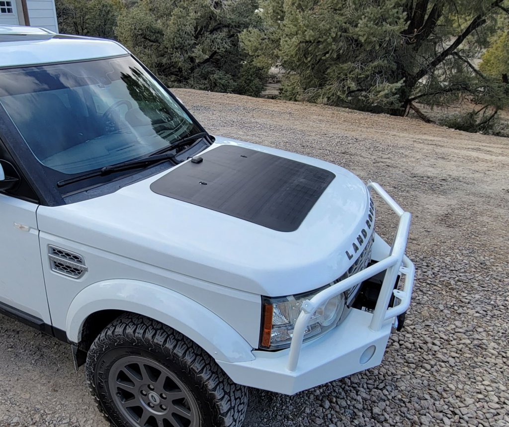

For similar reasons, I've installed a solar panel from Cascadia 4x4 that keeps the battery topped off when my LR4 is parked for prolonged durations.
