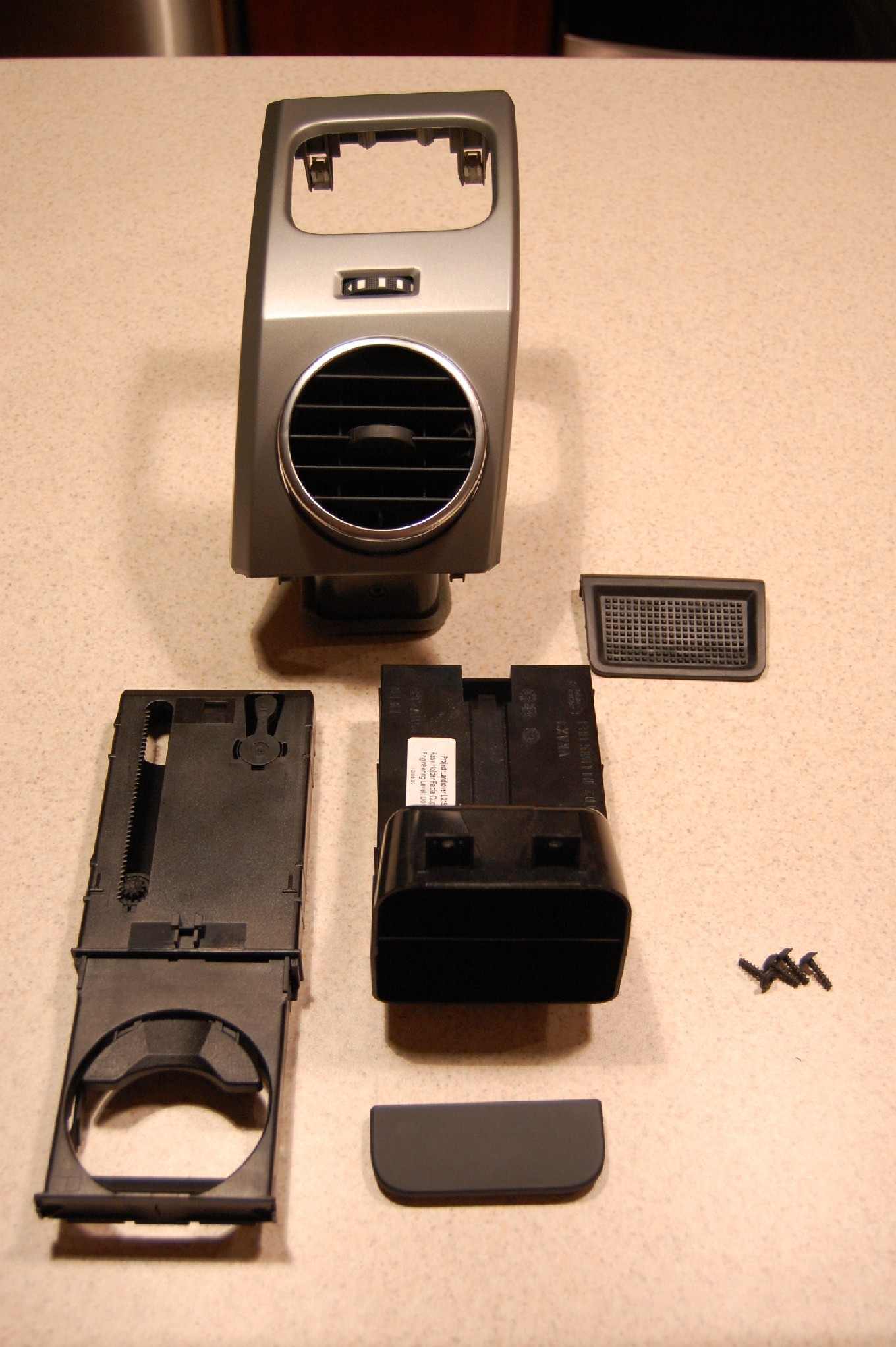

Well my OCD finally got the best of me and I pulled my right side air vent off again for inspection. In the attached picture I found that the main culprit is both the front face cover (bottom center) and the cup holder cassette (bottom left). I'm going to try putting a little dab of RTV on the face plate to hold it in position and I'm going to try some graphite lubricant on the cassette mounts and see if that helps. I'll post an update in about a week with results.
