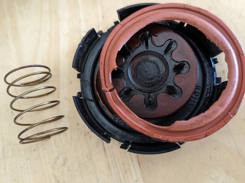

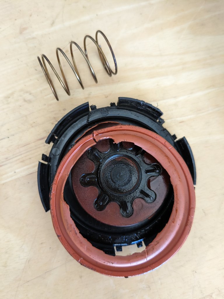

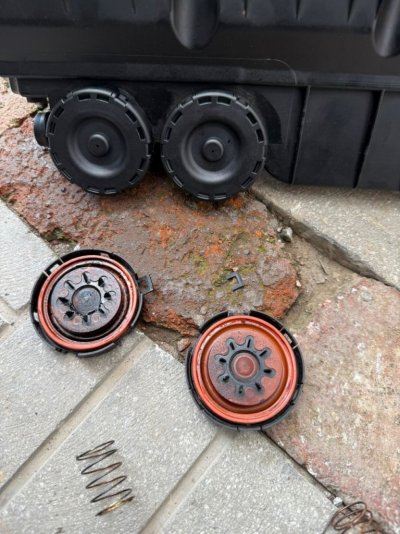

This PCV refresh is a good place to start if you haven’t already done it. It is probably the most common cause for the lean code at idle that I’ve seen on these forums. It’ll need to be done at some point anyway, so even if that’s not your problem, it’s not a waste of time.
