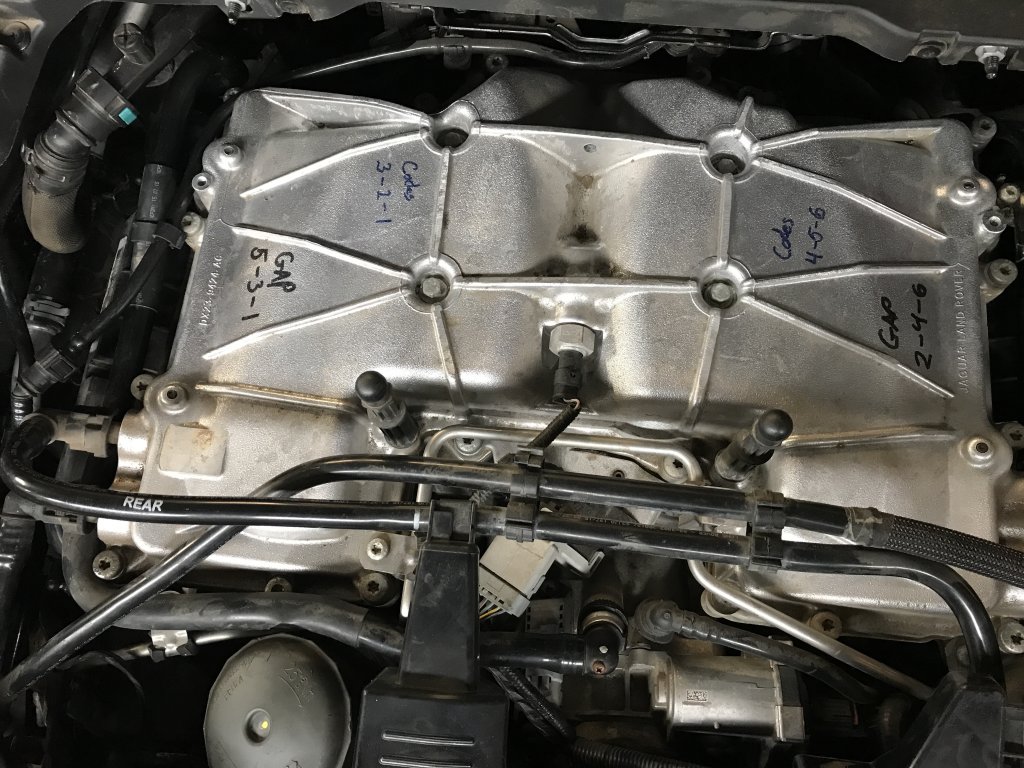

Do you think the misfire codes would call out the same way as the coils did or do you think it would revert to the V8 (10-13) layout?
Here is how at least my GAP tool denotes the cylinders, compared to how the engine codes denote them (true cylinder numbering).
What does the codes mean vs gap. If I got a code for misfire on cylinder 4 on the gap tool would that mean drivers side middle cylinder or drivers side front cylinder?
I wouldn’t have a problem pulling another injector if it is the middle cylinder
greiswig
Mar 1, 2021
724
332
SW Washington
“Codes” means when you pull a code, such as P0304, even with the GAP tool, the code itself is pointing to the appropriately-numbered cylinder. The GAP tool is just “reading the code” straight off the computer, not trying to interpret it. So P0304 would be #4, driver’s side front.
“GAP” on the other hand means that if you are trying to monitor live values for the #4 cylinder, you’ll want to ask the tool to look at #2 instead, because the live values seem to think there are 8 cylinders, with the odd ones all on the passenger side.
Note, however, that this is for a GAP tool that is configured to read the SCV6. I have no idea what your diesel-configured tool is doing.
