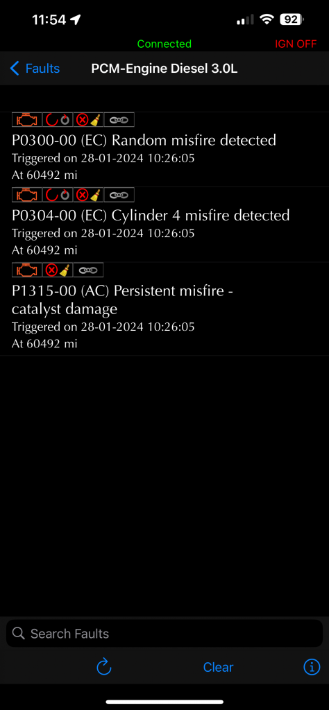

Update: I am a huge *****. I’ve been doing research on the issue trying to make sense out of everything before pulling the trigger to upgrade my IIDtool. While doing research I had an idea to check if I had any lean/ricg codes stored in the PCM when I took a screenshot of the misfire code last year. Come to find out that the whole entire time the issue was on cylinder number 4… so I’ve been doing work on the wrong cylinder this entire time… **** me!!!!
Anyway I plan on attacking cylinder 4 this Thursday or Friday and replacing the plug, coil, and injector since I have working spare parts for each of them. Hopefully I report back with good news. If not, I might have to bite the bullet on a $388 IID Tool swap.
Sorry for your troubles. Why does your diagnostic tool seem to think it’s looking at a diesel engine? I’m not sure how trustworthy are the readings you’re getting.
