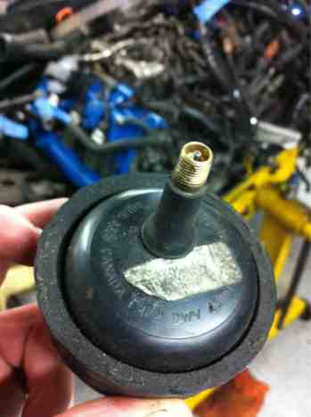

Build yourself one of these its like 3.00 and 1/2hr everyone should have one of these.
waspjr123
Dec 25, 2013
73
Its a intake leak tester
That one is for my audi its a 2.5" PVC end cap with a hole drilled in the Center where you put a rubber valve stem in you then pull your maf sensor off and put that in place. And use a tire air chuck to put shop air in regulated to 8-10 psi but pop the oil fill cap off so you done pressurize your crank case. Then the leaks are obvious. And u can use soapy water in a spray bottle. Measure your maf housing and size it accordingly
