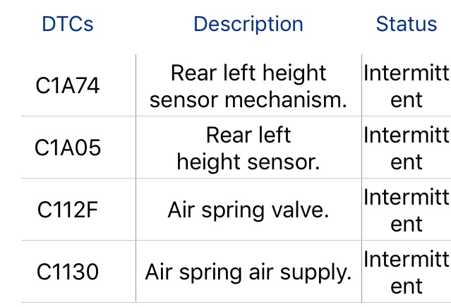

I bought the iLAND diagnostic tool. There are a bunch of codes (!). The codes in the ride level control module are c1a74, c1a05, c112f, c1130. They are all classified as “intermittent” and it makes sense because the orange/yellow light in the instrument panel comes on sporadically but always goes away after I shut the LR3 off and restart later when I’m leaving work. I’m thinking I need to replace the rear left height sensor, clear codes and then go from there. Appreciate any insight!
