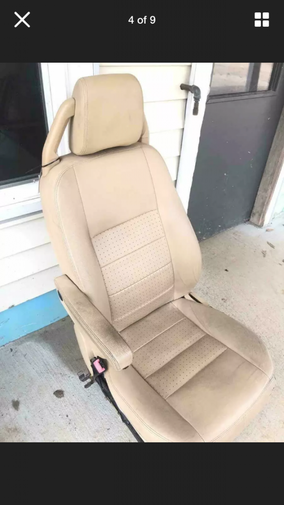

My Landrover LR3 2008 SE style V8 has the front driver seat play back and forth.
When accelerating the seat moves just slightly I'd say 2-3 mm back and it's enough to feel a little concerned when accelerating.
Has anybody experienced play forward/back issues on Landrover front passenger or driver seat?
Picture of what this type of seat looks like generally speaking.
