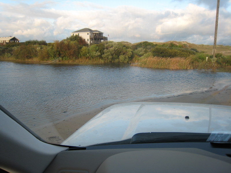

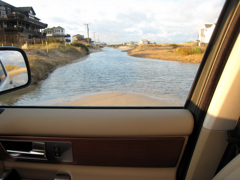

Today I went to the beach and was not so adventurous. I mostly drove on the beach and only went to the dunes whose puddles I was familiar with. I actually went into one very slow and steady (one of the ones that previously caused a rush of water over the hood) and it was a decidedly different experience. Almost humbling. Going fast made it seem like a monster hole, going slow and steady made it feel like the easily crossable 18" puddle it was.
Attached are a few images from today. You can see the flooded 'roads' between dunes. The second one I went through and at it's deepest it was probably 16" only. And the last shot of the wild Mustang on the dune at sunset is why it's all worth the fun ;)
