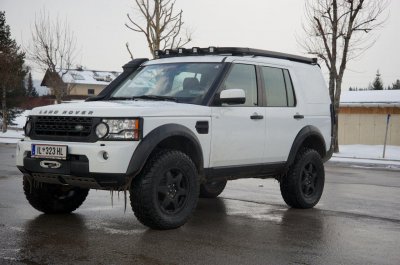

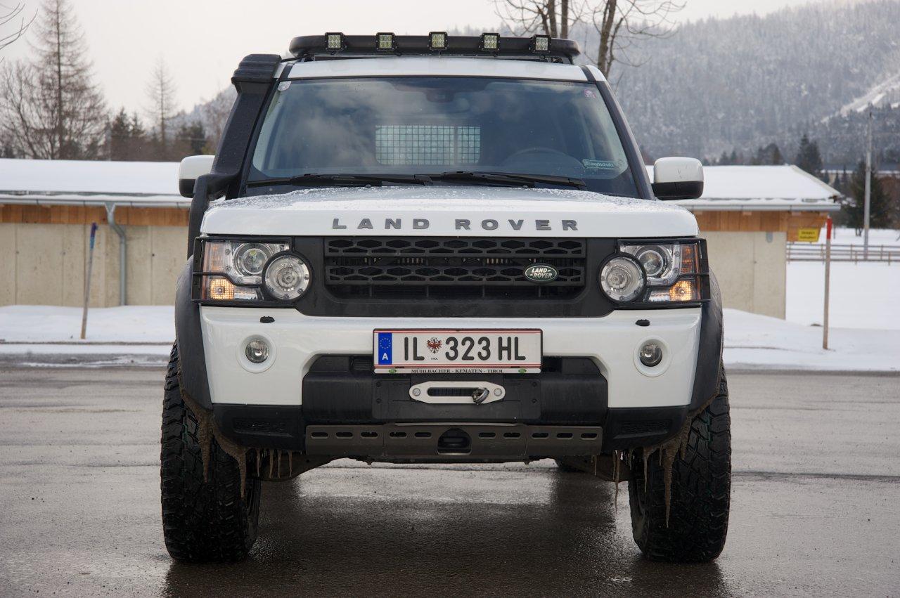

hi,
im writing from austria,
i use the 18" rims from compomotive with cooper st maxx tires 275/70/18
they are slightly higher than 33" tires.
it is quite a bit of work - but it is worth to do it because you upgrade the
lr4 to a next "level".....
greetings from tyrol
adi

Very nice floda! Did you paint the rear wondow or is this a special model?
floda
Jan 6, 2013
14
thanks!
no this is a commercial truck - if you buy it here like this you can save tax.
mine is very plain and simple without the features of the hse or se model.
but it has the v6 diesel engine and the 8 speed transmission and that was important to me.
adi

thanks a lot!! i can't wait that the snow melts to test the mods i done during winter.....
but at it does not look like there is an end in sight.
regards
adi

Floda - who makes that rack? can you tell me more about it? Love the lights!
