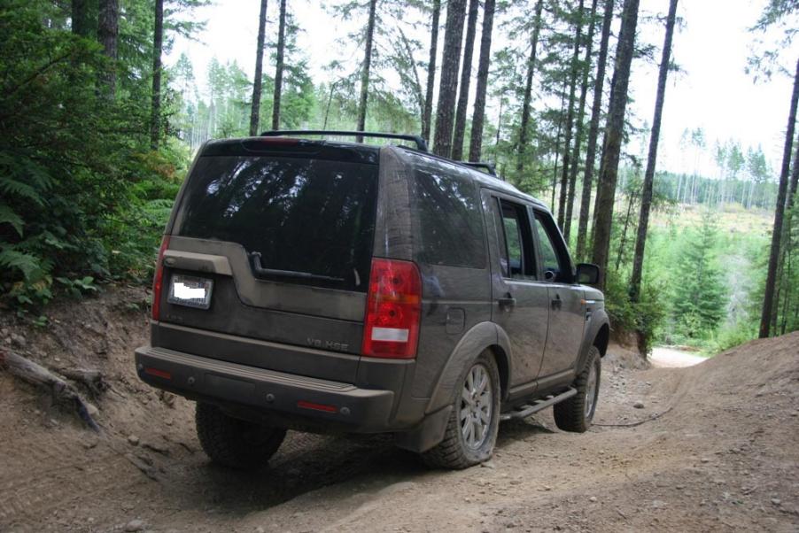

Anyway, the other rigs you listed are SOLID AXLE....which is a very different set-up than our 4xindi suspension. The knock on indi suspensions is that they don't articulate from one side of the axle to the other. The EAS addresses that with the cross-link valves. I have a picture, not sure if it's small enough for me to upload, I'll try....of that very thing happening. You can see that one wheel getting stuffed forced air into the other side and pushed the other wheel down...like a beam axle. You go coils, you lose that. Sounds like that head mechanic doesn't know $hit.... :)

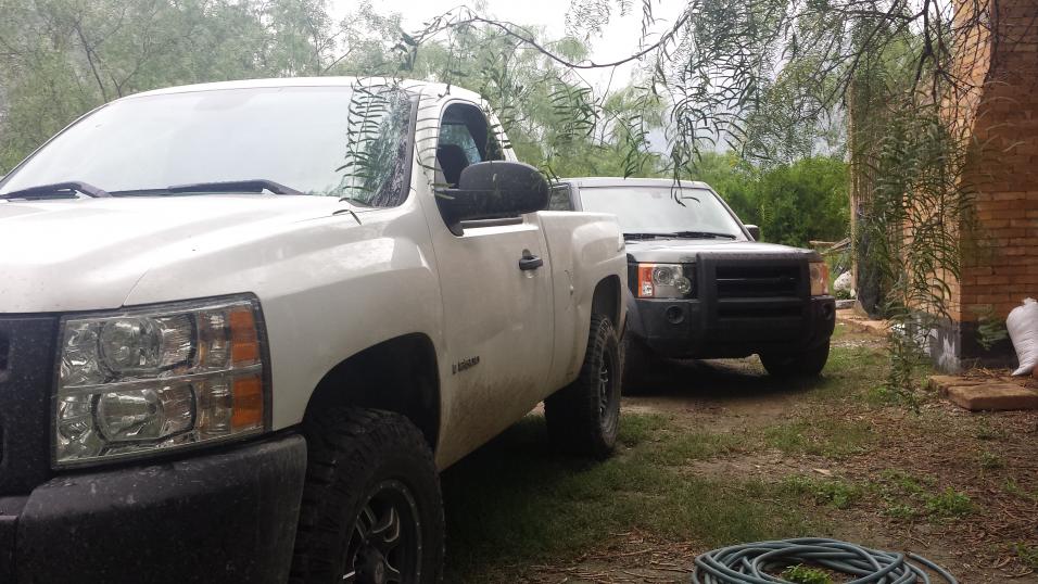

Anyhow and as a brief story just for the sake of it: last week we went offroading to the local national park and the LR3 performed PERFECTLY wearing latitude tires!! a friend of mine went in his silverado with rancho suspension and lift wearing big duratracs and he had a harder time crossing the river than I did (rocks are EXTREMELY loose in the river bed)!! hahaha I made fun of him for hours :cool:
here's a pic of both vehicles
