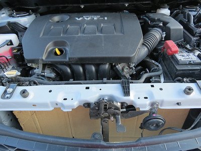

A 15 minute idle in those temps would get me to about 1/3-1/2 of normal operating temp. After a 10 minute drive I would be very close to normal operating temp, if not all the way. Mine is a 5.0L so not a direct comparison, but that is my experience, and we see very cold temps up here. You could always try a Saskatchewan thermostat and see if that makes a difference. If it does then I would replace the thermostat and go from there.
By the way, Saskatchewan thermostat = see attached pic

Ha! I used a "Saskatchewan Thermostat" on my 1972 Austin Marina in Wisconsin.
Mine had a one-time adjustable aperture in the middle.
Had to calibrate the size of the aperture vs the temperature and be sure to install the summer version before it got too warm out.
