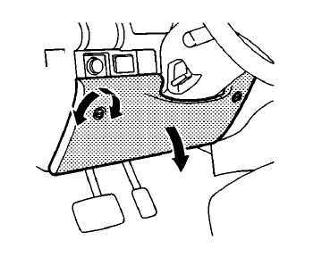

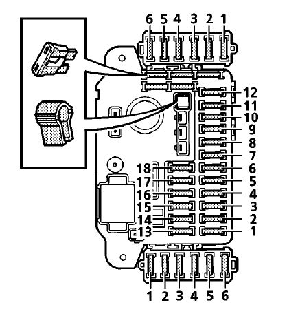

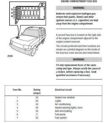

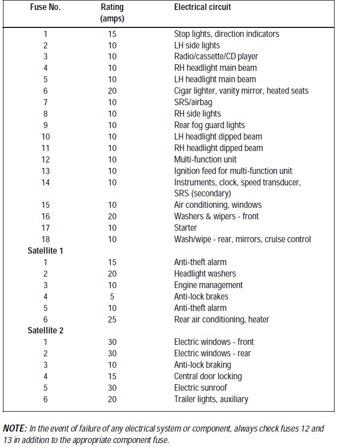

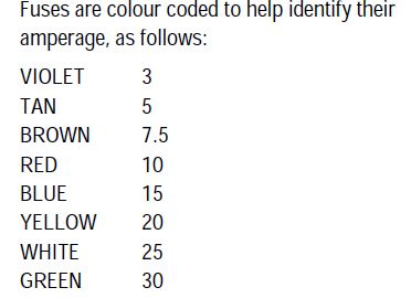

I hope the below pics help.

Sounds like either a blown fuse:
Check the following fuses
15
16
20 - this is the one I think may be bad.
33
If the fuses are good, then you may need to reset the BECM, not saying it can be done by disconnecting the battery, but it can't hurt... disconnect battery for 20 minutes and see if everything works now.

I had the same problem as the originator of the thread...after having the headliner replaced(imagine that), no radio-no dome lights-climate control reset when truck was off...It was the #20 fuse...I thought the guys that put in the headliner put something back together wrong, and this thread saved the hassle of having those guys back out to remove the headliner and look for the problem...all I did was google my problem and here you are...I really appreciate the forum and the guys that bother to post such good information...I'm new to this forum, I just wanted to say thanks...
