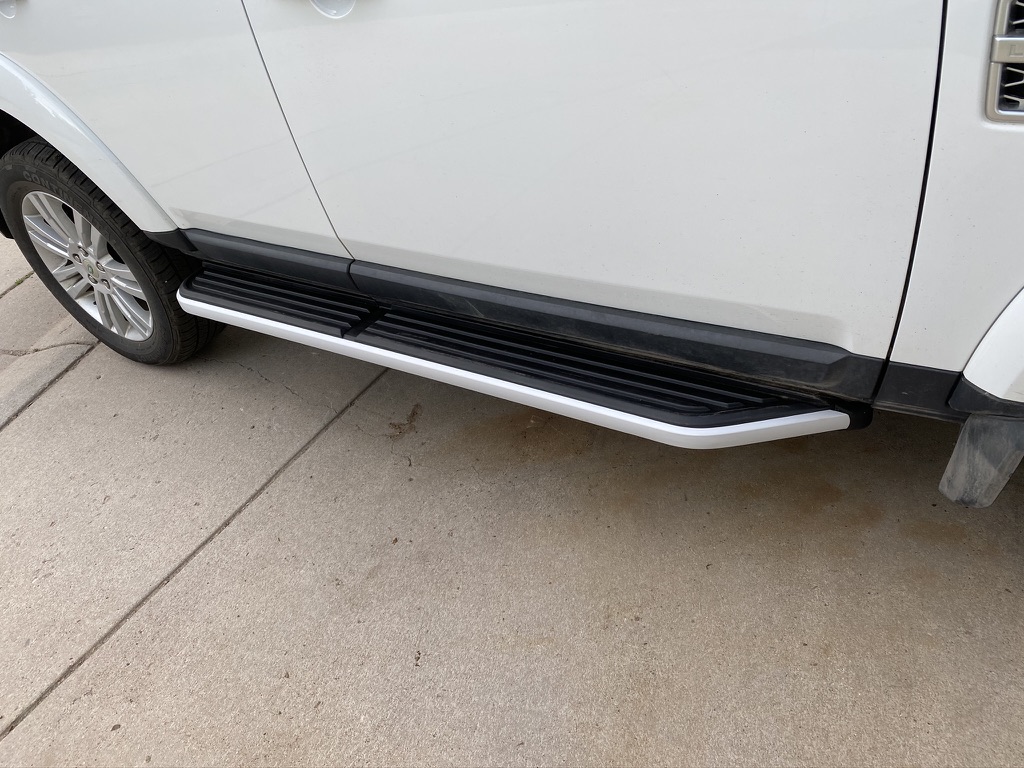

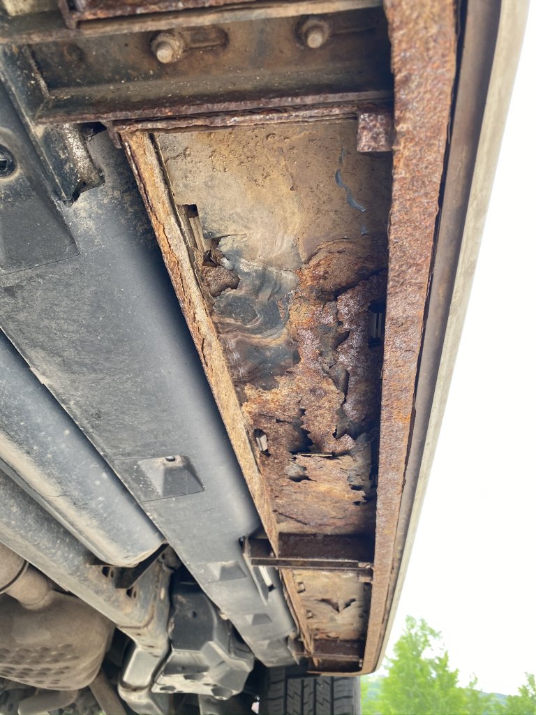

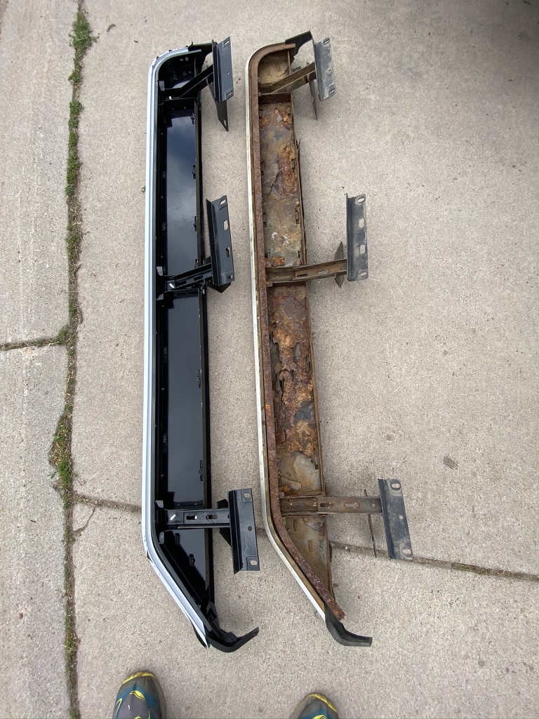

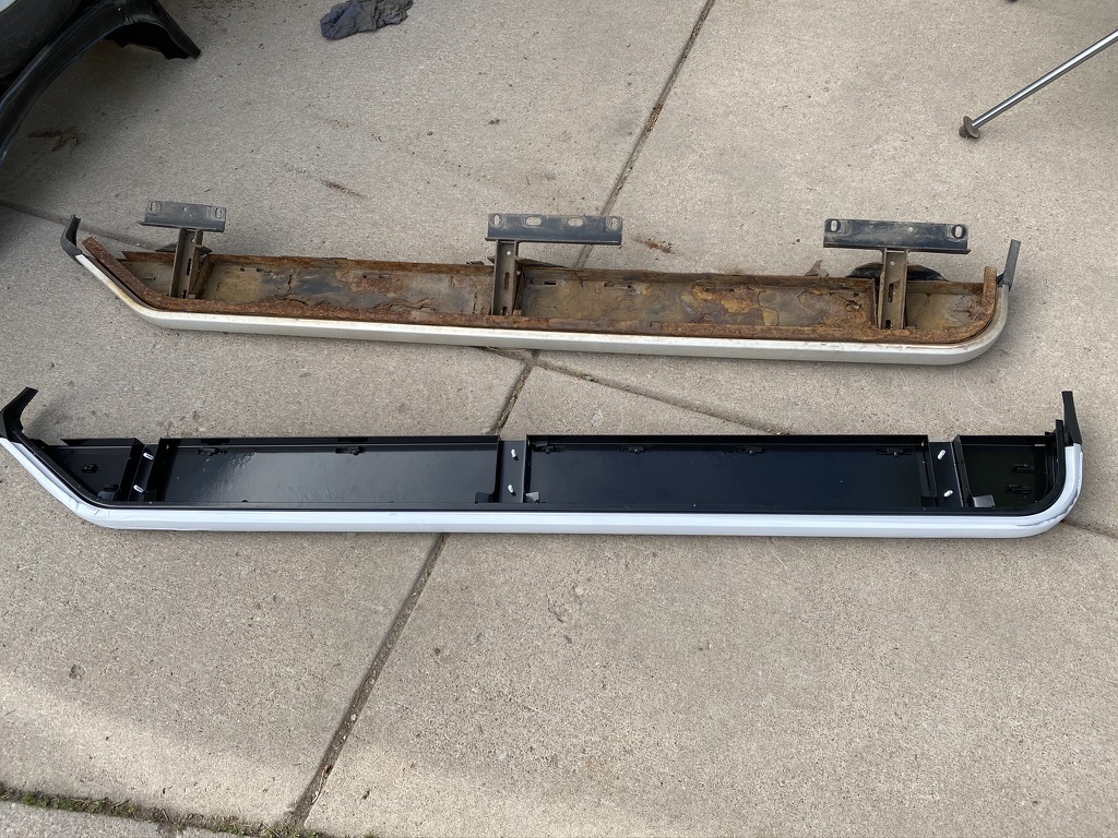

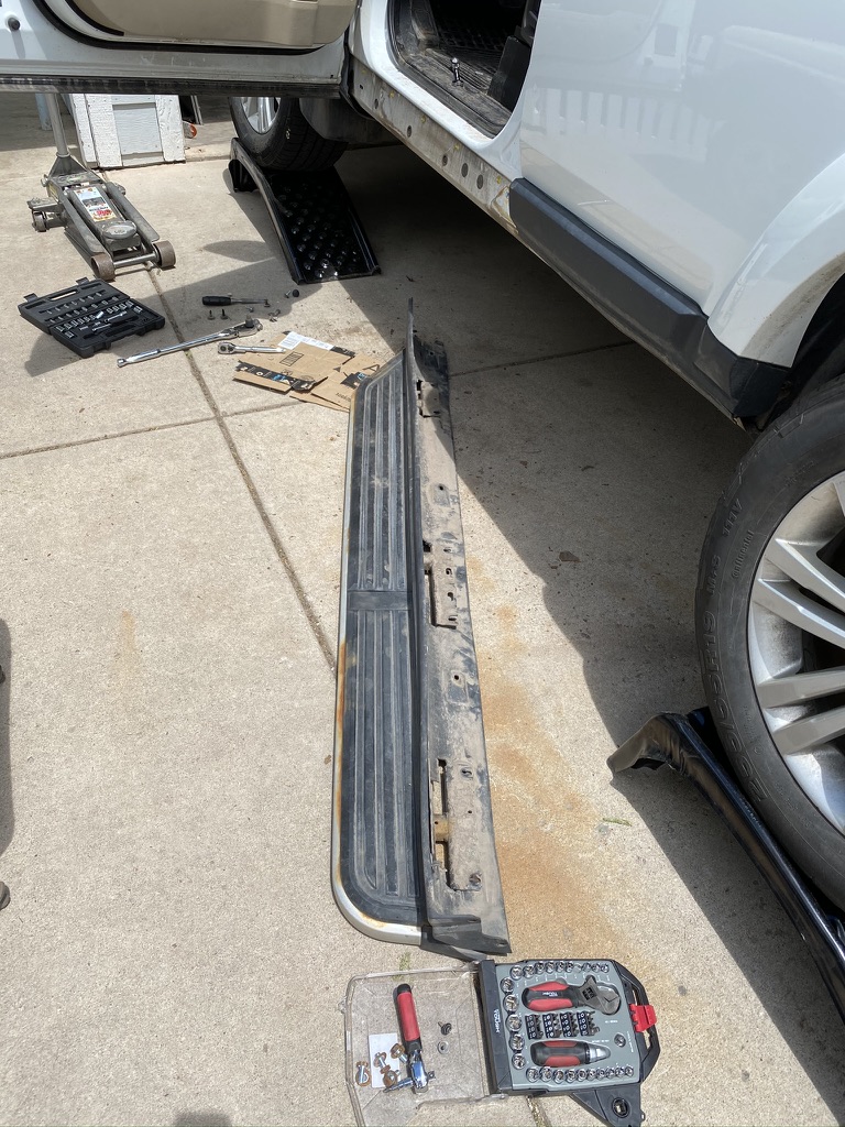

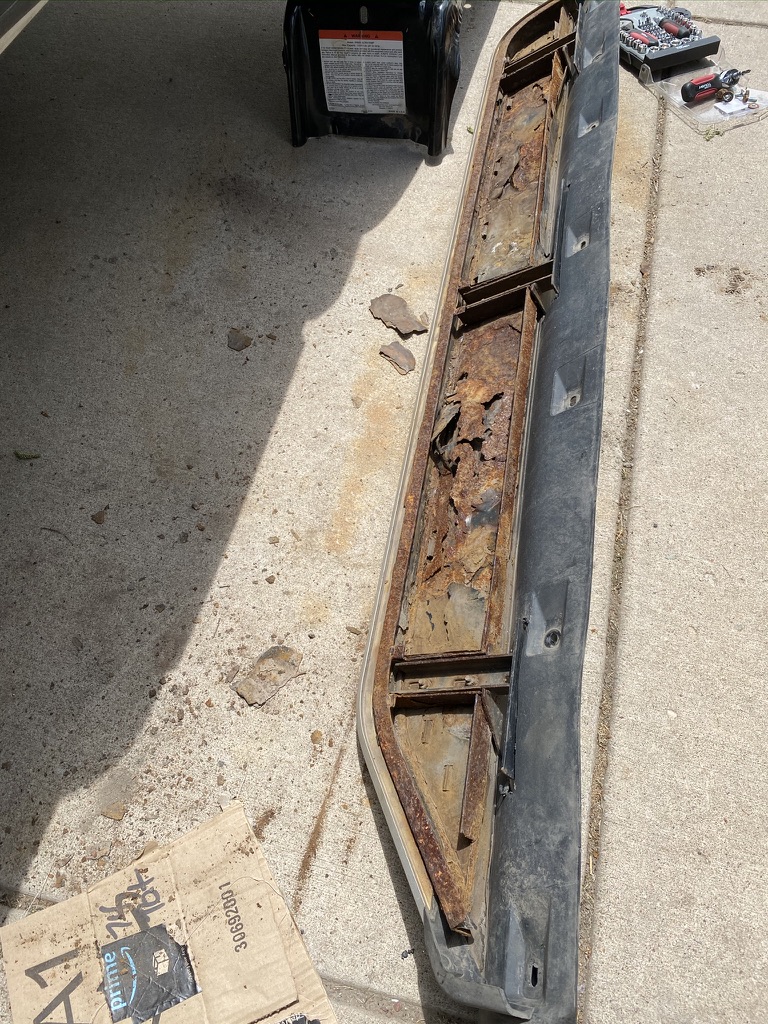

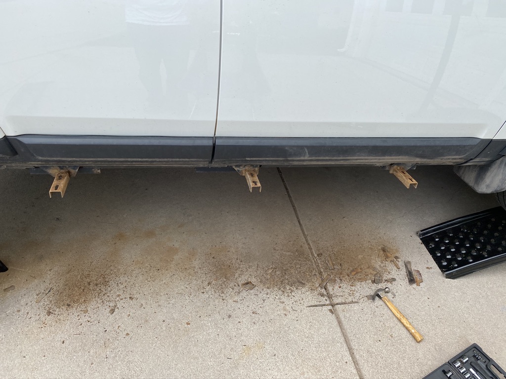

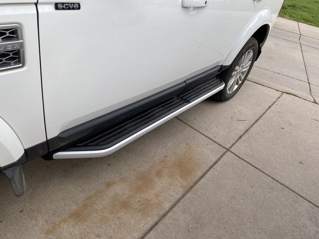

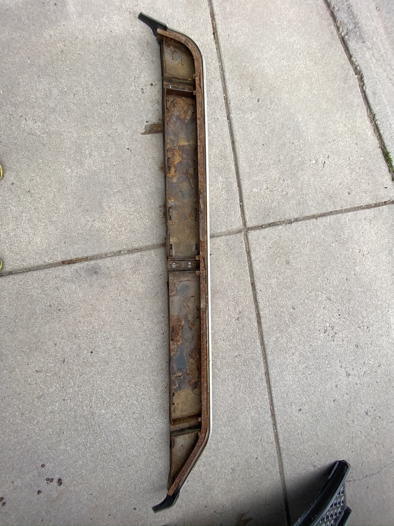

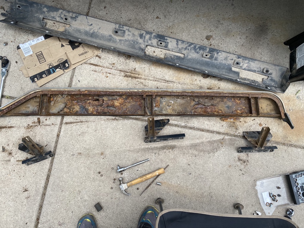

So I finally replaced mine with some cheap knockoffs from Ebay. I have a 2014 LR4 Lux that is the newer version with the LED headlights and a few other telltales. I thought this automatically meant the running boards were the beefier ones we discuss here being side impact protection and needed to be kept on. Well maybe this is not true until the 2015's, maybe thre was another change? Because the ones I took off looked about 20% beefier than the $200 ones I replaced the with. C0B00FB5-25D6-4F24-A609-B5589D7E147A_1_102_o.jpeg DDCC38CB-3718-4452-8C52-5A937F57ED21_1_105_c.jpegF85FF3E5-BB3E-404A-80CF-AEB8ABA621E4_1_105_c.jpeg00908A4D-8710-468D-9D33-CA78FF54EC6C_1_105_c.jpeg
1,412
The LR running boards are a joke. They begin to have serious corrosion issues within a few years that is hidden by the aluminum and plastic. They became "structural" in the final few years with the only thing changing was the alumnum blocks they mounted too. LR should have a free replacement policy. Having things rust out completely on vehicles 4 years old is unnacceptable and shows the lack of quality of the OEM components.
