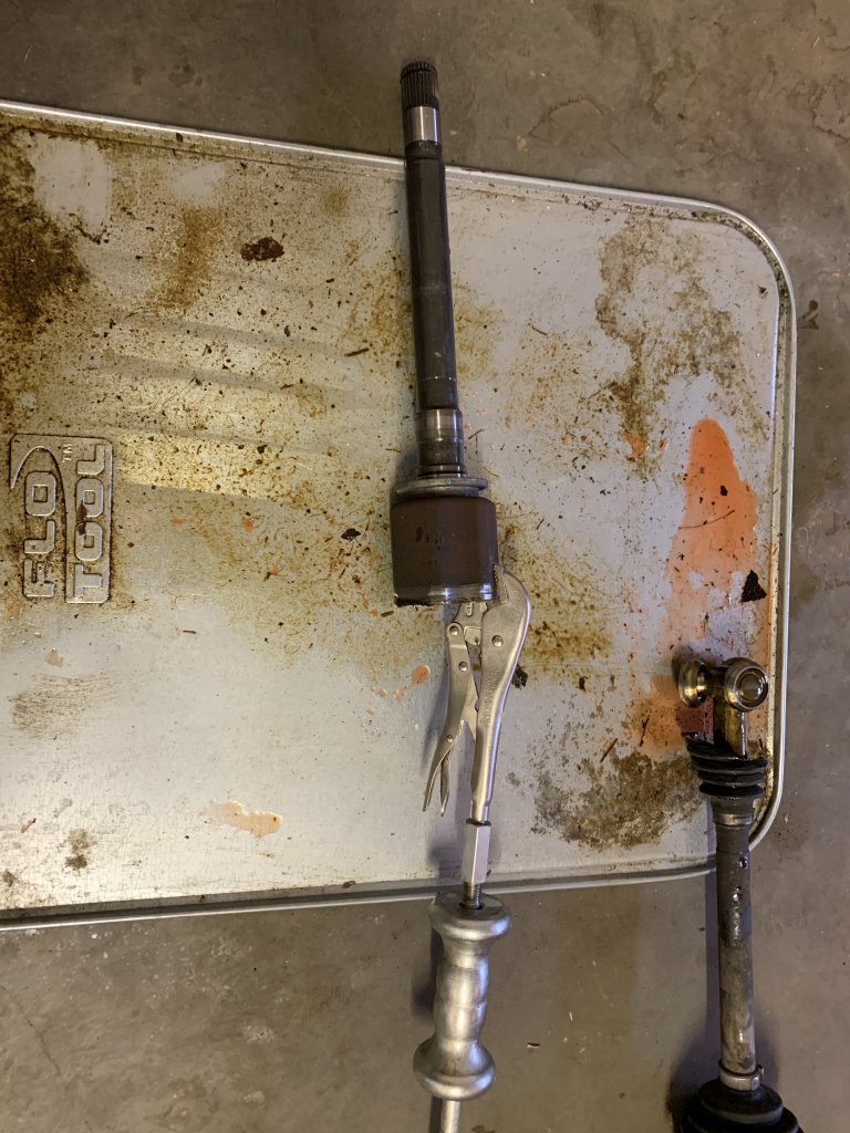

Below is a picture of my setup for removal. Cut boot and separate half shaft. Use slide hammer attached to the sleeve (on the shaft). I had to pull about 4 times on the slide hammer before it broke free from the differential. I was really relieved as the pry bar method seemed to be a chore.

Ok, so with a little bit of thinking, I realized if the slide hammer helped me get the axle off, certainly it could also help me refit. I made sure all was lined up (the splines mesh prior to the c clip). My biggest fear was tearing the boot, but decided to chance it. With the slide hammer under the vehicle, oriented towards the other side of the car and the hook like attachment, I gave it a couple whacks and it was refitted.
