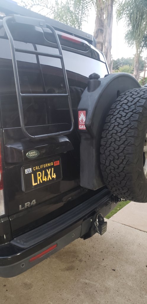

Why would it matter where the cap is?
I have the Terrafirma TF053 installed and combined with the Titan fuel tank. The cap matters as far as distance from the aux fuel cap to the truck's gas cap.
Try fueling up the truck when your parked on the wrong side of the fuel pump. Yes, it doable, BUT its easier to transfer gas from the fuel cap on the aux fuel tank to the truck if it was closer. Meaning, if the cap was near the hinge vs at the end of the swing out arm.

That's right, haven't thought about that... By the way, have you used this setup much on corrugated road, harder terrain? I mean, it remains solid even in tougher conditions?

Oh, and does the Terrafirma allow you to move the tyre closer to the hatch when the tank is not there? I'm realising that that price-wise, the spare carrier + Titan tank are coming close to a T44 bumper. Still cheaper, of course. I think I'll make a table with all the prices and pros/cons to help me decide:).
I did a shakedown run out in Lucerne Valley, Johnson Valley, and Mojave Desert this past weekend. Flew through bumpy fire roads ( between 20-60 mph), uneven terrain, incline/decline, and sections where there were rolling hills for a straight 20 miles, and it held up well. Not even a single peep from it.
I shared my experience with Lucky8 and Eddie from Terrafirma, he's the main guy there.
I would 100% recommend it.
