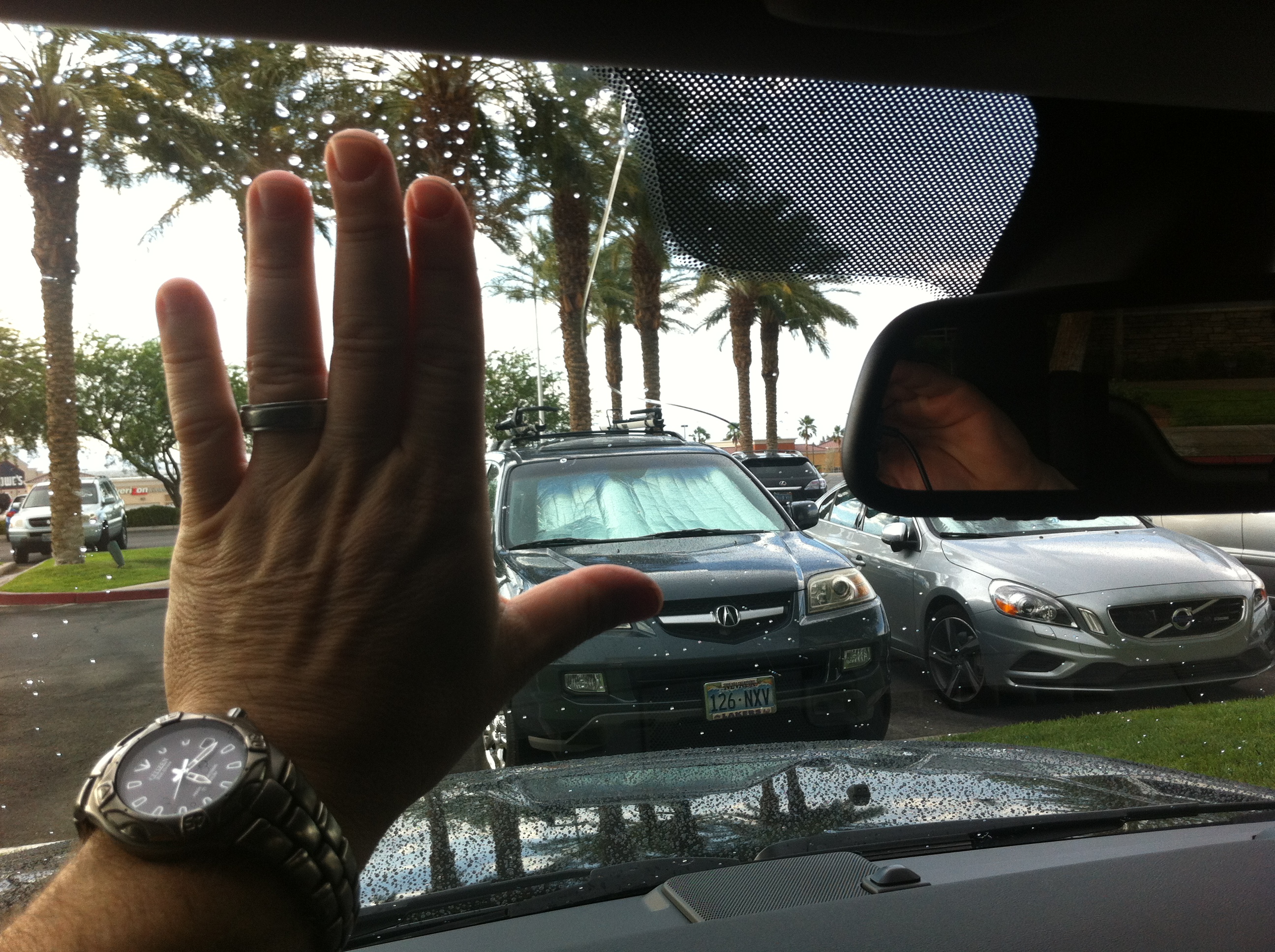

Sounds like good advice. I am probably similar to you and could get it done, but for the risk, $150 seems like a small price to pay. Of course I am going to have to wait a little as the new expense is going to be the deductible to replace my windshield. Was driving on the highway today and must have take a rock to the windshield. The crack is now from the tip of my pointer finger to beyond the end of my thumb! Picture to follow

Today's gift from the highway

That stinks. Hope you don't have a heated shield.
