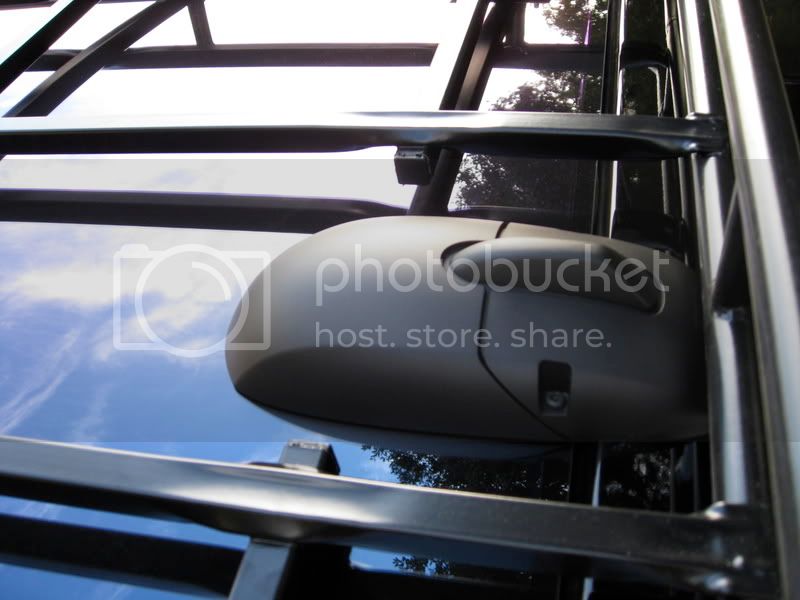

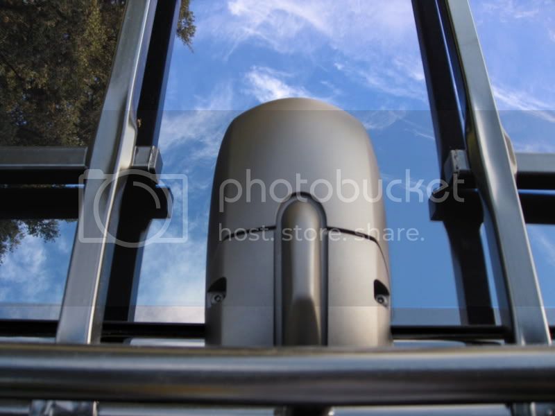

Does anyone know if the BROWNCHURCH ROOF RACK fits an LR3 with a sharkfin? I cant tell from BOAZ's pics. Thanks!
duckdive
Sep 14, 2006
720
You have to cut a small section (about 4 inches) from the rack to fit around the fin.

Duckdive helped me with that before I bought mine. Thanks again. :cool:
It's a 5 minute $2.00 modification. Cut a small piece out with a hacksaw. Put in some silicone sealant and a couple furniture plugs, and you're good to go.
Here's a couple close-ups of mine.
