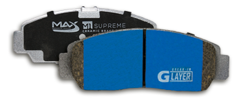

I gave maxbrakes a call as the LR4 is not listed on there website. Even there best slotted rotors are cheaper than OE rotors from British Atlantic. Which version did you buy for your LR? Thanks
(Black) Slotted and cross drilled rotors with premium (Blue) ceramic brake pads. You have call and order which might take 2 weeks.
I’m not a big fan of ceramic brake pads as they are softer. Less dust but softer. The rotors have great specs if the machine work is as precise as they say I might bite. Do you feel it’s quality stuff? Will probably get OE pads or EBC green stuff to complement as they only carry ceramic pads.
They have Metallic pads as well but have no experience with metallic. As far as quality i have been using them on all my cars and for friends as well with zero issues for the last 4 years.
