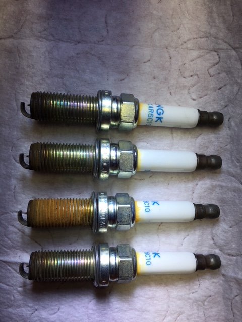

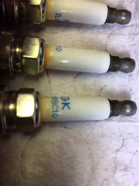

Don't leave them too long or they tend to "weld" into the head. At 100k the tips were ok but they were worn and some threads were corroded. One plug was oddly rusted.
