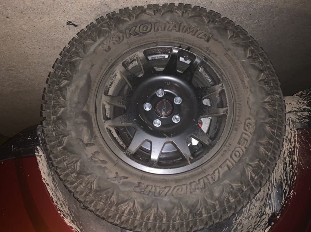

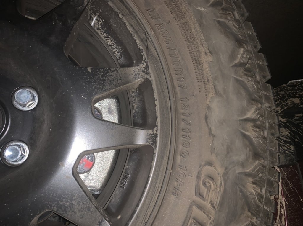

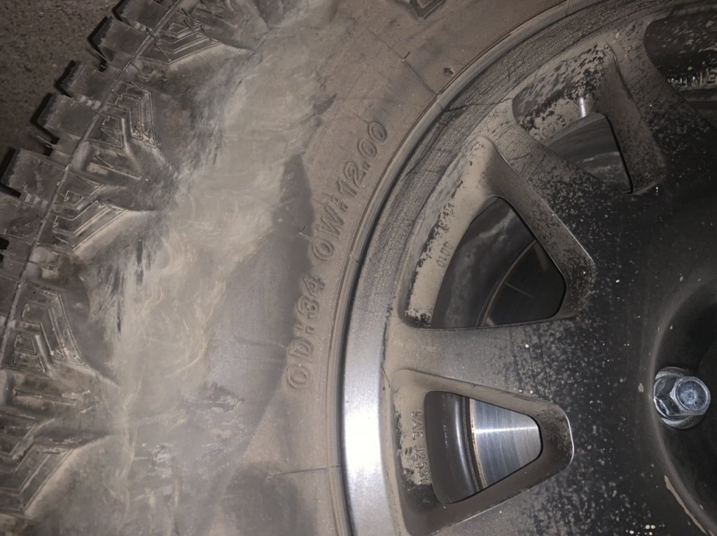

Hold on a sec. how are you fitting 17" wheels, let alone 34" tires!?
Rotor, Caliper, and carrier change.
I haven't done it, but it has been done.
After that, cut those horns down and start trimming until you can fit what tires your want. These trucks are getting old enough that taking a Sawzall, Angle grinder and heat gun to them isn't as shocking as it once was. 35x12.5 has been done by Lucky 8.
I'm currently running 33.3" K02's.
We've come a long ways from the dark days of the 2012 when some Cooper Zeons on 19's were all you could hope for. :)
