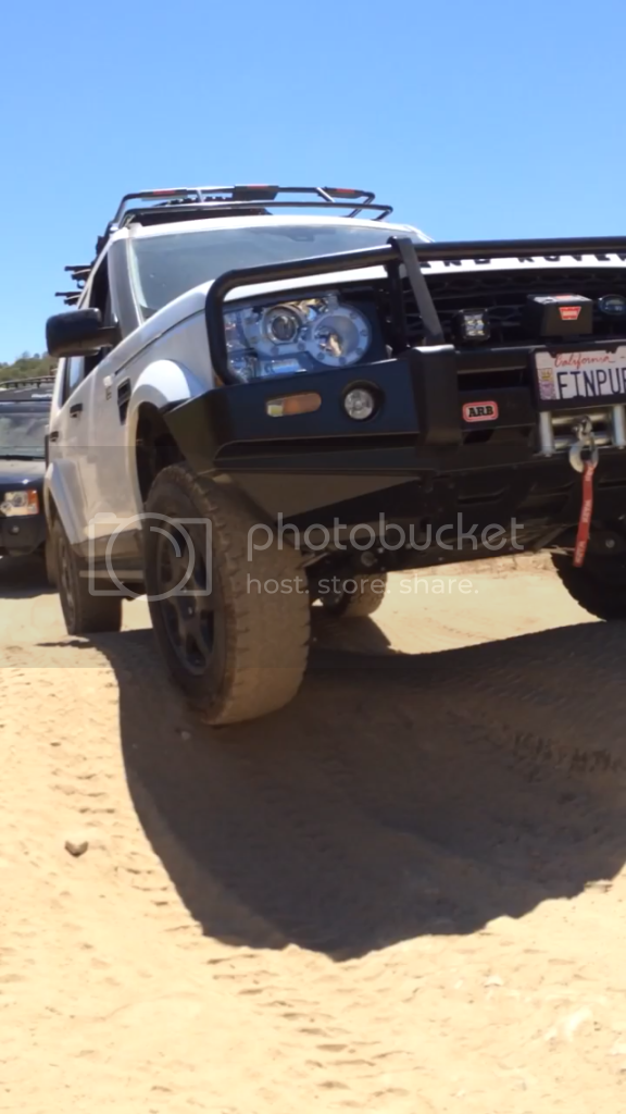

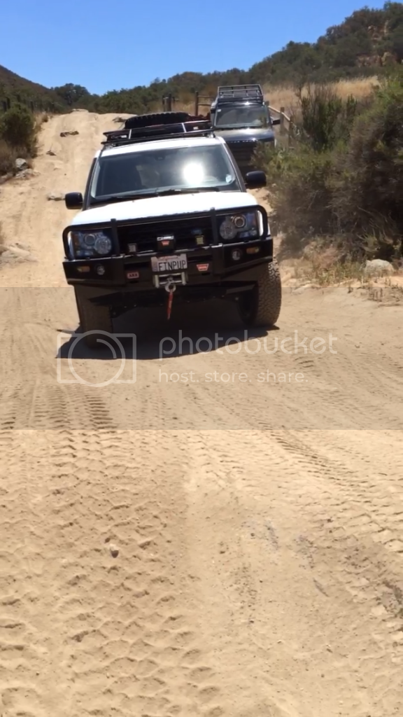

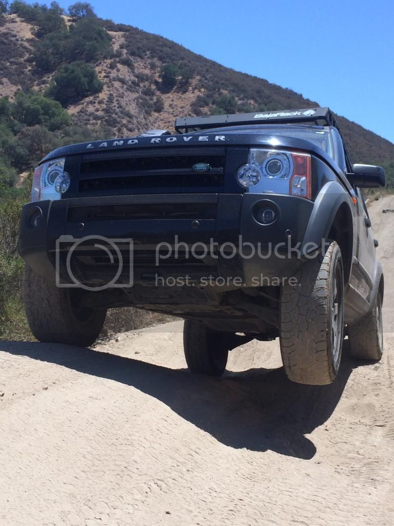

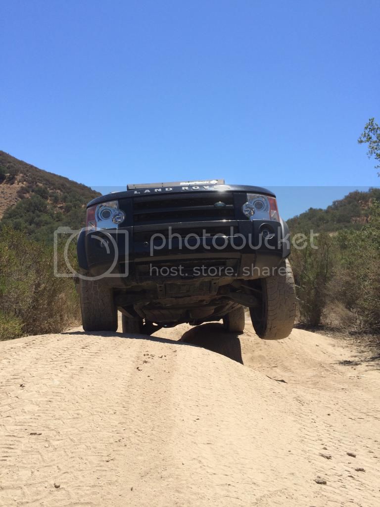

A couple more of us in the simple obstacle course, and a rather crappy video of some bumps - nothing special.
