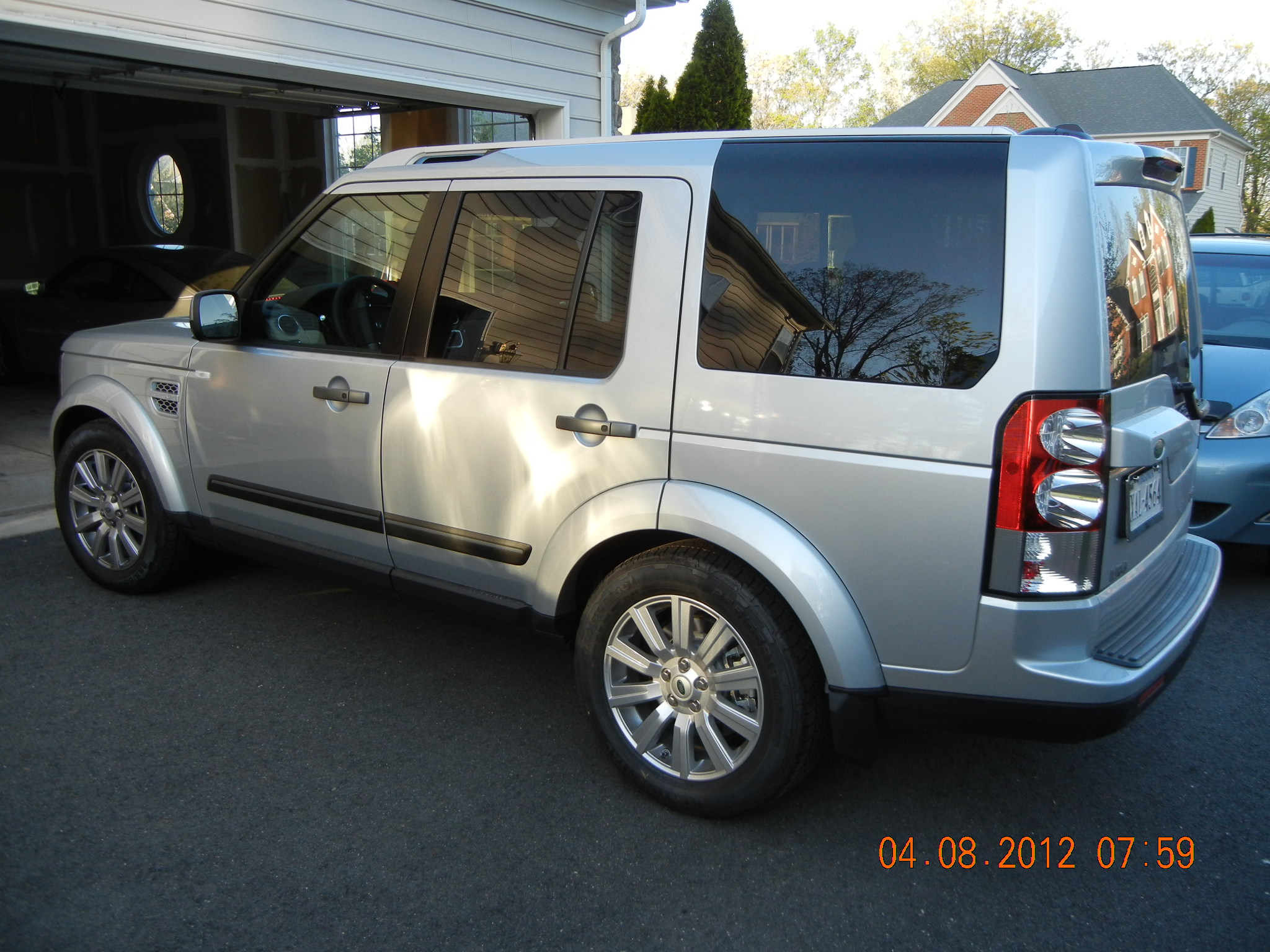

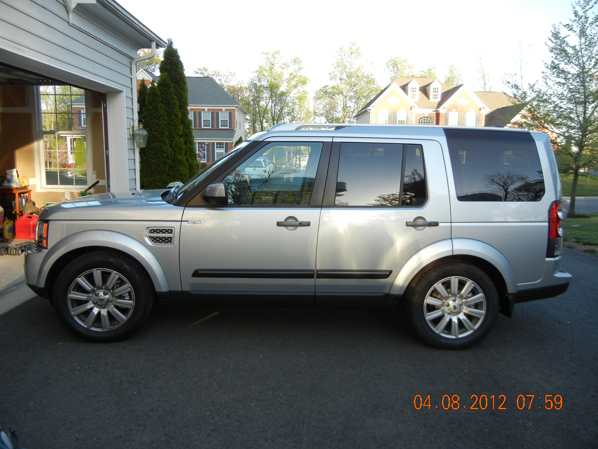

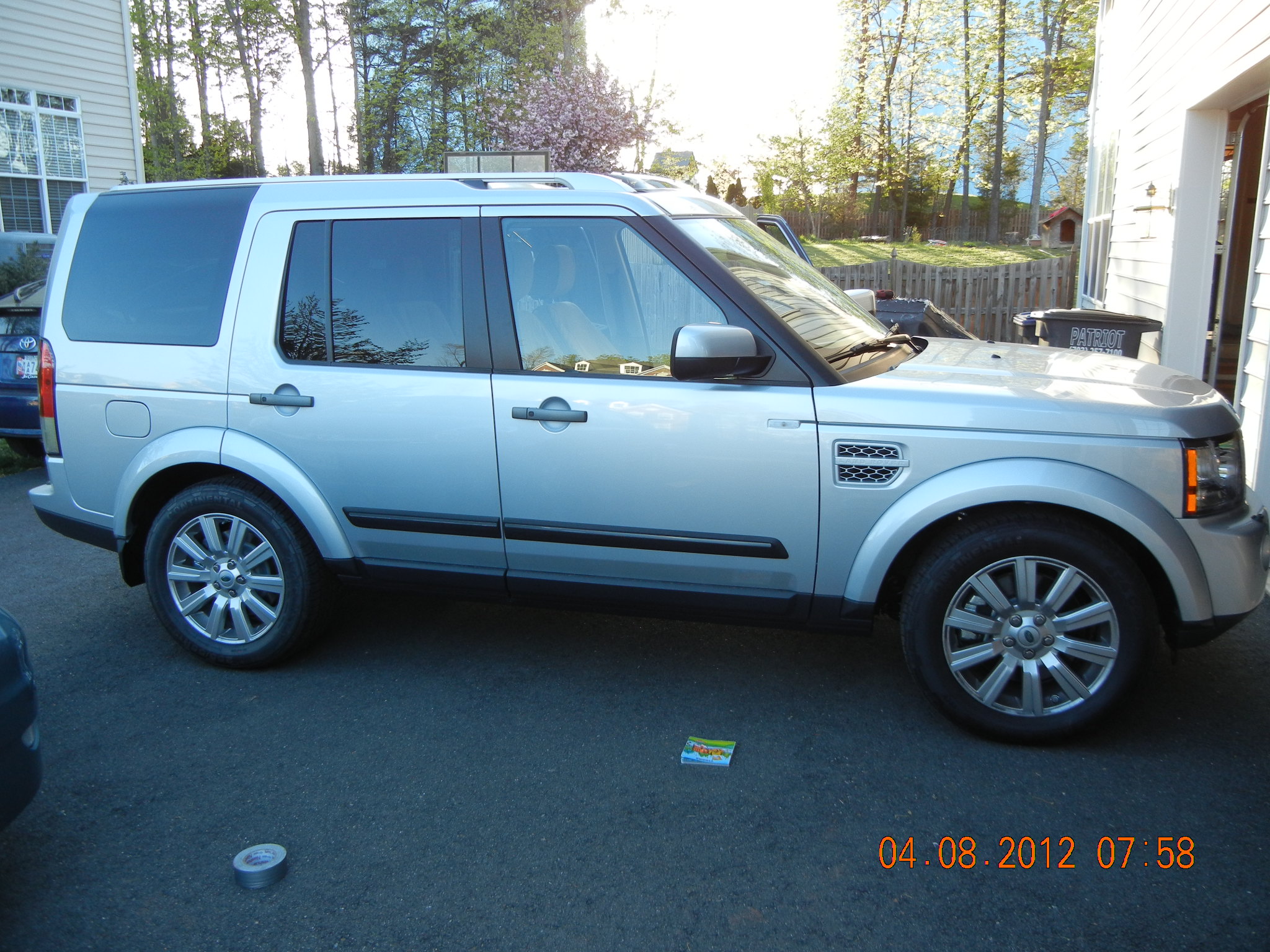

I completely agree with getting the dealer to install as you want to get them as straight as possible. I got the black with chrome inserts. In terms of installation - you should pay more than couple of hundred bucks as i asked a local land rover service shop and quoted me a about 180 than took it to land rover and they installed everyting i wanted including the parts for only $1400:
- full length roof rails
- side moldings, and
- sunroof visor
Pics attached of the finished product
