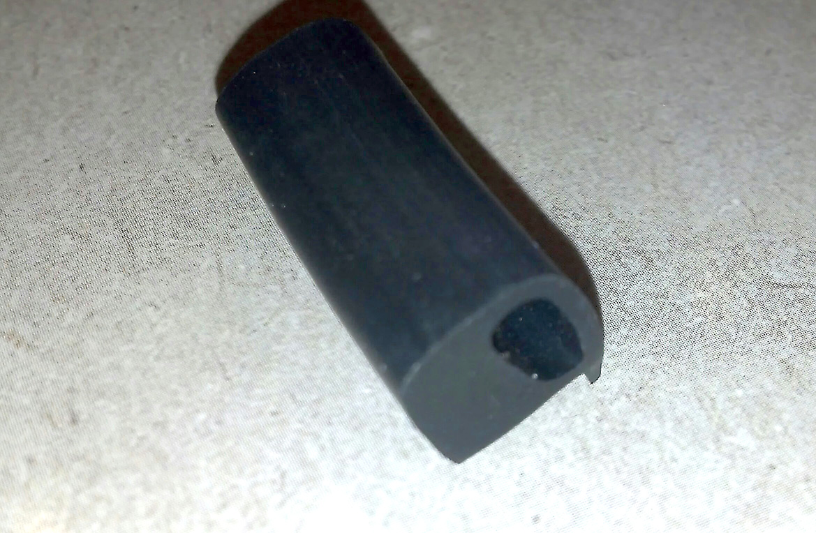

While the window was stuck open and I was driving over a bump, this rubber piece fell out. It is about 1.25" long. Can anyone identify this piece and where it goes?
Thanks!

...noticed nothing like it on the exploded parts diagram. Does it look like it broke off of a larger part?

Thanks for looking that up Houm_WA. It does not appear to be broken off of anything as the ends are finished and there was no glue or residue that I could find. There is that hole that extends through the middle, so I suppose it could slip onto something. Also a lip. It looks like the the rubber moulding or insulation you might find around a window or a door but inspecting the sunroof glass I did not readily see a place it would go.
