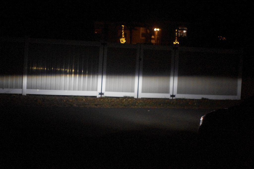

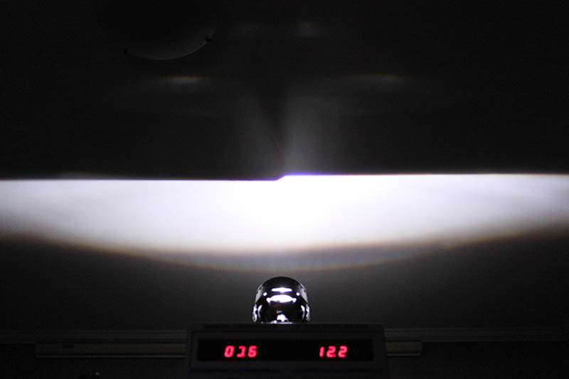

My first issue when i got my LR4 was that the headlights were aimed terribly low. I could literally see the cutoff on the ground about 100ft in front of me. make sure this isnt your issue.
I adjusted the height and replaced the bulbs (because why not) with Osram Laser Night Breaker bulbs. the brightness and visibility is amazingly better. Brightness is on par with the Mercedes.
The one thing that still bothers me though is the cutoff dips down at the right and left sides, making visibility on the sides of the road no where near as far as directly in front of me. Unfortunately the only way to fix this is to disassemble the headlights and adjust the cutoff shield...somthign that was never intended to be a serviceable item.
these images are borrowed and not of either car, but a good example of the issues with the LR4 headlight beam.
how the LR4 cutoff is (this is not an LR4, just similar)
how a proper cutoff shoudl look
