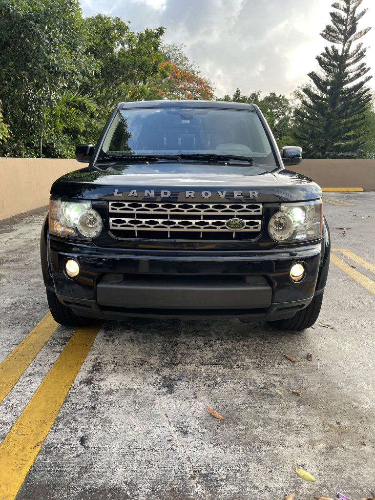

I have a 2010 lr4 with hid and I swapped to led. No issues, no codes. Looks great, visibility is much much better. Although I live in miami so I don’t deal with snow. But I have had no issues switching the C4BA89E6-BB37-4DF3-9B93-C0789D11101F.jpeg headlights to led. No issues at all.

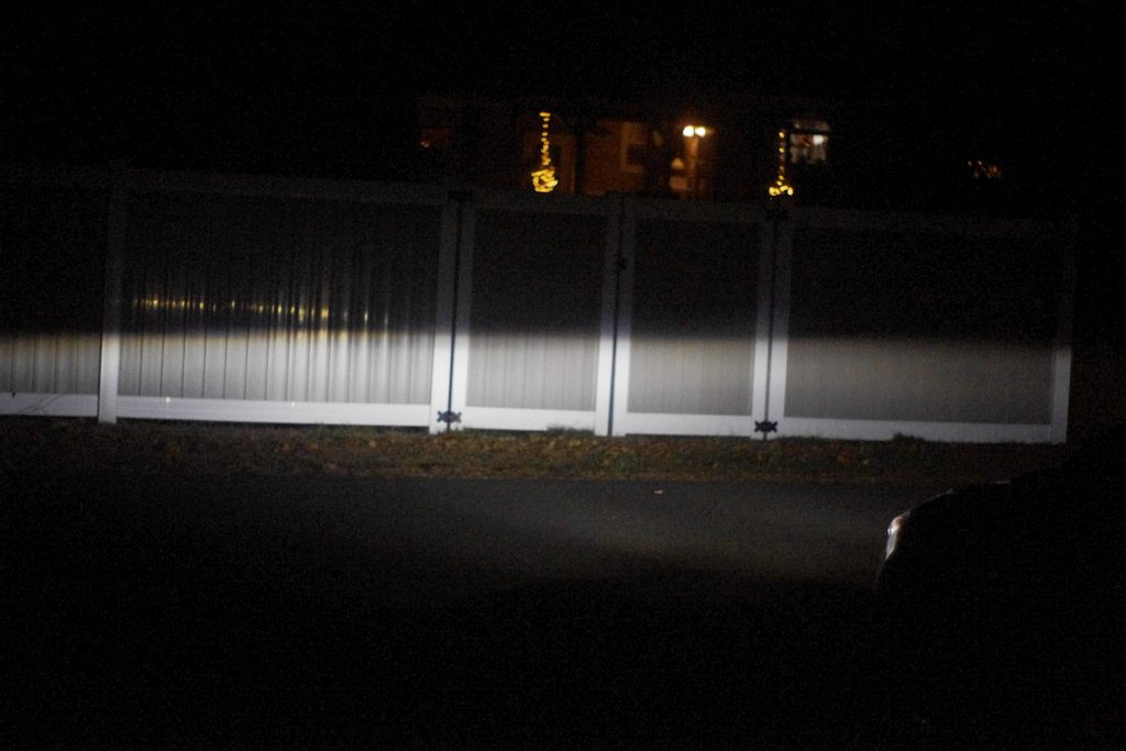

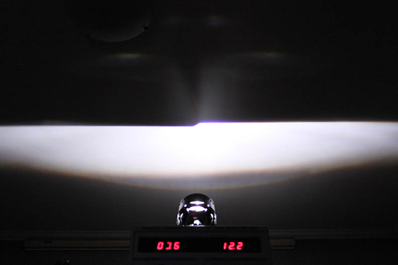

these images are borrowed and not of either car, but a good example of the issues with the LR4 headlight beam.
how the LR4 cutoff is (this is not an LR4, just similar)
how a proper cutoff shoudl look
I believe it’s done for safety. If a car is coming in the opposing lane you would shine the light in their eyes. The downward cutoff wouldn’t. Btw, I believe your comparison. Pictures are headlight low beam to headlight high beam because the high beam still has a cut off on the top but does extend to the sides as in your picture 2. I say this bc I just tested on my Ftype the low/high beam against my garage wall I could see that high beam does extend sideways.
