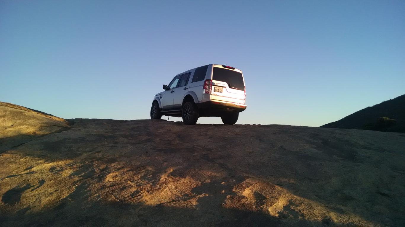

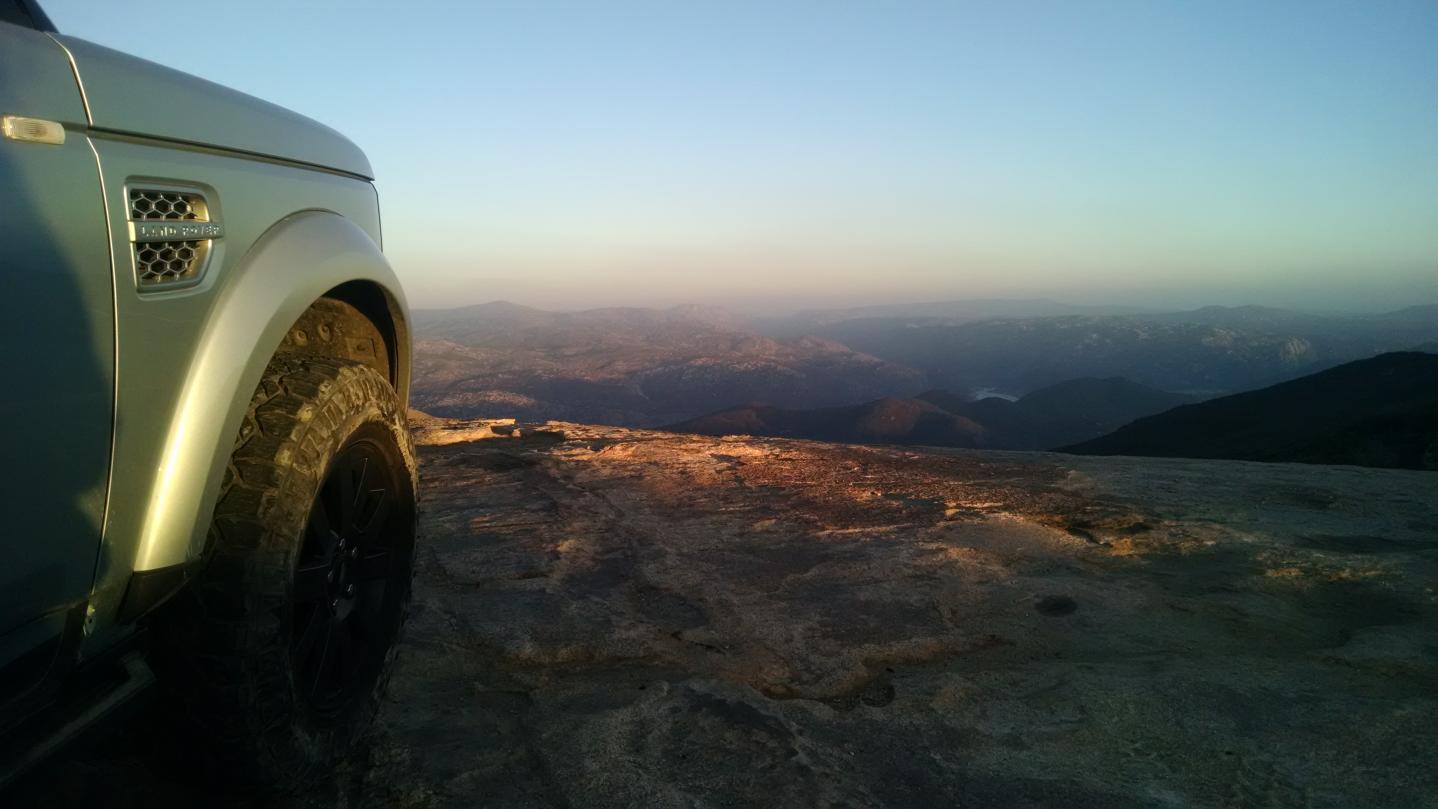

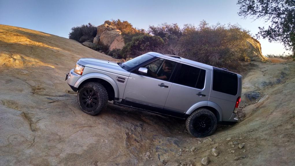

Yes I took my truck out to the local mountains and definitely lots of creaking. But there not new anymore :)
