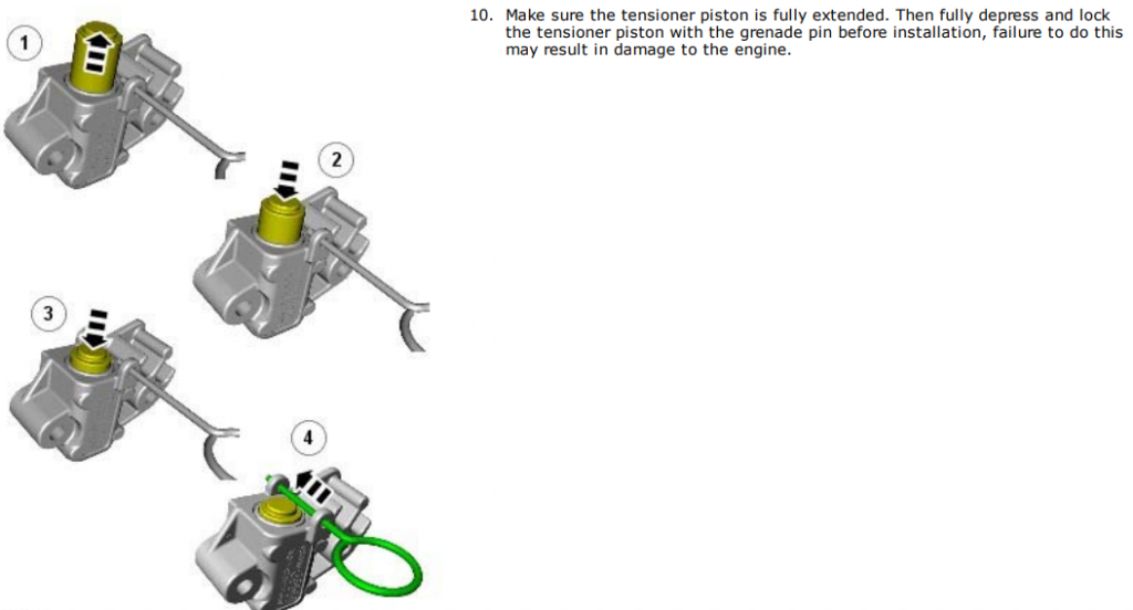

The more I go down the rabbit hole with this timing chain job the more I realize the small nuances make a difference in overall project success... Today, I'm trying to figure out the procedure with the timing chain tensioners. Having watched many YouTube videos and posts on the web I'm seeing a pattern where if the tensioners are not properly prepared and installed it can lead to poor results. The Land Rover manual has this:

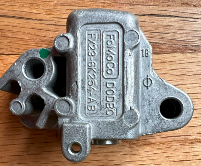

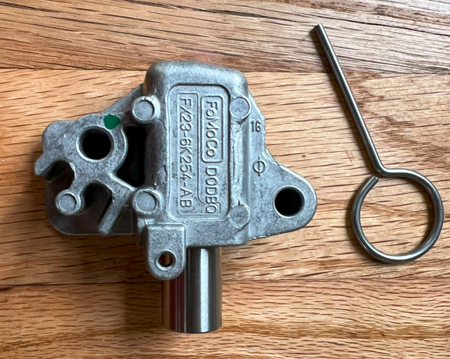

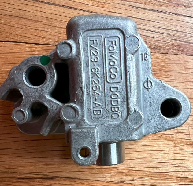

I ended up pulling the grenade pins before installation, then using some channel locks (per the video above) to squeeze it back in again. One of the tensioners with the grenade pin removed was very tight initially (I used a vice to get it moving); the tensioner pin then rachets back in. To reset the tensioner pin you have to squeeze it all the way back in (using a nut to get it below the face of the tensioner) and then it's "springy" again, here as some images:
Pin removed and tensioner at full extension:
On the way back in:
Further back in but just prior to the point where it's springy again (the face of the tensioner has to go in even more than shown):
When I installed the tensioners and pulled the grenade pin I was pulling the chain guide away from the tensioner and heard a nice snap as it released on to the chain guide.

I believe they are pre-primed but that's also why I was asking the question, go back to the original post and see what I posted from the workshop manual; they spell out this procedure but it's not clear to me why??? I did it anyway!...
