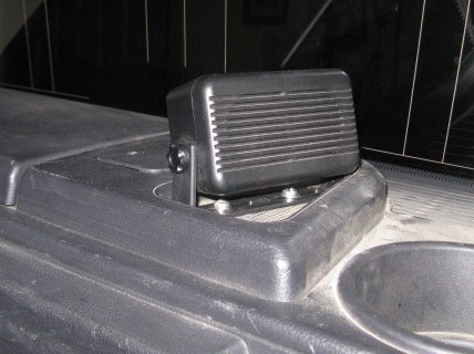

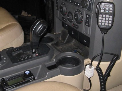

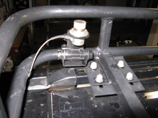

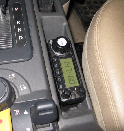

I have an Icom 208H. Here are a few pics I snapped. Didn't take any during istall. No drilling for the antenna. Ran the antenna wire from the unit out grommet behind tail light up and out the hatch to my roofrack. Yes that's my call sign.

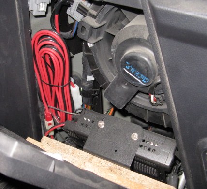

I have the 8900 which is the newer model and mounted it under the passenger seat. Put my head unit in the same place. Used a panavise mount for hanging th mic. Will get a pic up soon.
