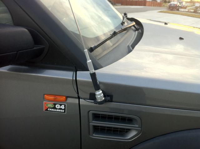

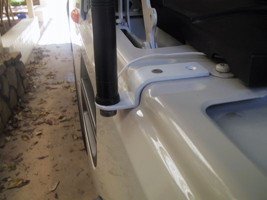

In Australia, guys clamp onto the rear top of the roof track and run RG58U out the rear hatch or mount a bracket on the front or side of the bonnet.
A magnetic mount works well out the top of the rear hatch.

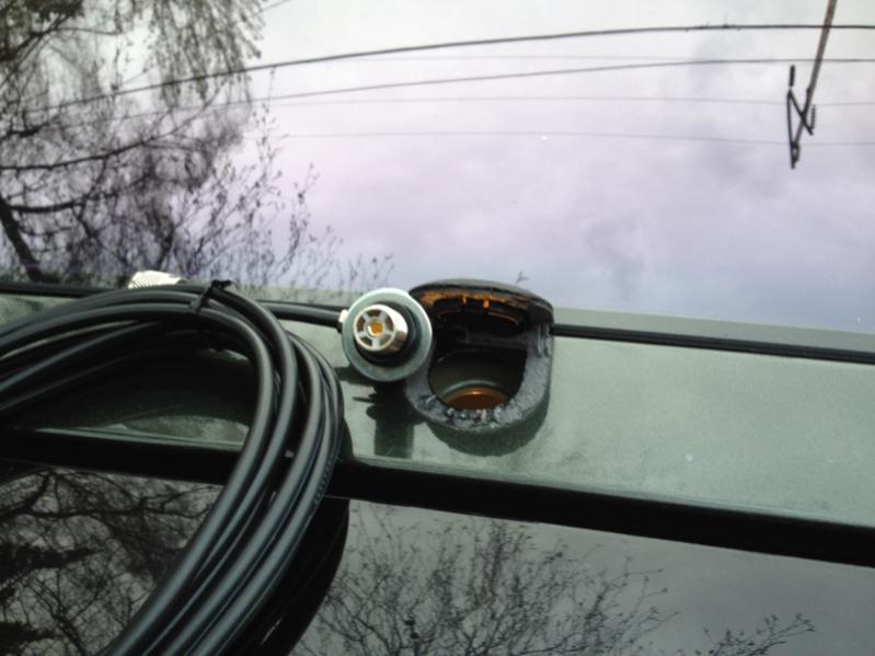

I opened it and seems like it will do. Its actually on the metal and can offer ground plane if mounted correctly. Plus I have the detachable kind so the antenna is only mounted when needed. Attaching pic for explanation.
I won't have to drill holes as it is already present, and the wiring would be through the trims as the access is readily available.

Geo, looks like you have found a creative solution, well done. Still, ask youself these questions before you proceed.
1. Are you going to have to reseal that cap after each time you dismount the antenna?
If not.
2. Will this area be 100% watertight? You don't want water getting down into that cavity.
GeoRover
Jan 4, 2012
160
duckdive, I did think about those points.
Here is what I am going to do. Drill a hole on the plastic cover the size of the mount. Thread it in and use rubber washer on top that came with it and a nut. At the base I will attach a metal bracket to the lower threaded part of the mount. Screw it on top and seal the plastic cover back on the metal body with epoxy. The mount will stick outside permanently, it has a top screw-in cap to protect it from water. The base bracket will provide snug tight fit and grounding to the antenna.
I think this is my plan. I will take pics when I do this mount. I am very confident this will be the ultimate clean solution.
Also I noticed that this part of the body is curved enough to not hold water for seeping in. I poured water there on it to see what happens. It doesn't even stay there to even cause any leakeage inside. Regardless it will be sealed anyway and is not even going to be an issue.
