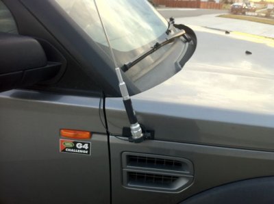

In Australia, guys clamp onto the rear top of the roof track and run RG58U out the rear hatch or mount a bracket on the front or side of the bonnet.
A magnetic mount works well out the top of the rear hatch.
