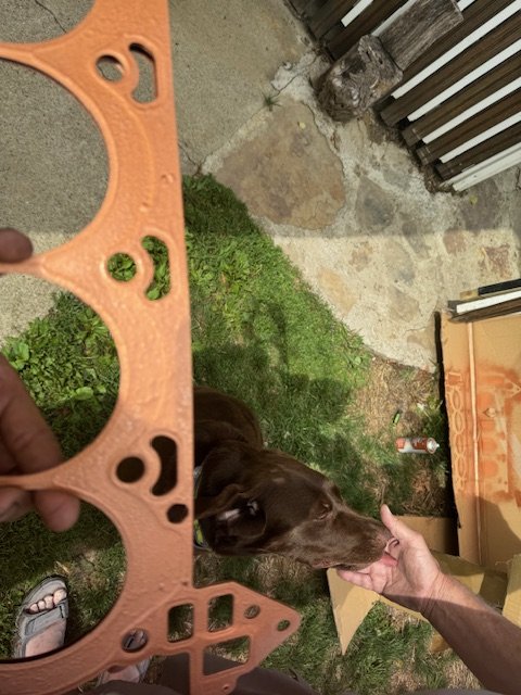

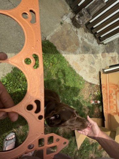

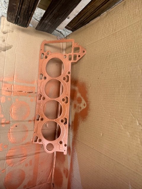

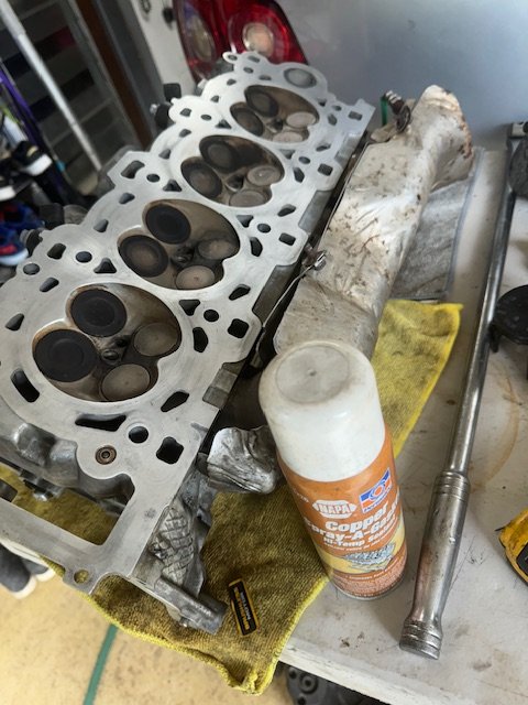

After speaking to my machinist (who checked heads as perfectly flat), he mentioned he used Permatex Copper Spray on his high performance builds for racing and has had no issues with it. Managed to convince me it wont hurt. I picked up OEM gaskets, sprayed and installed em'... so far truck is running just fine. Will be monitoring fluid levels for some time to see if this stuff actually works. Would have preferred to use the Hylomar, but needed to get her on the road. My only caution to others who may venture to consider this option, is to be careful with the install as it's easy to scarp the stuff off. I had a friend gently slide the gasket into place while holding the head an inch from mating surface.
