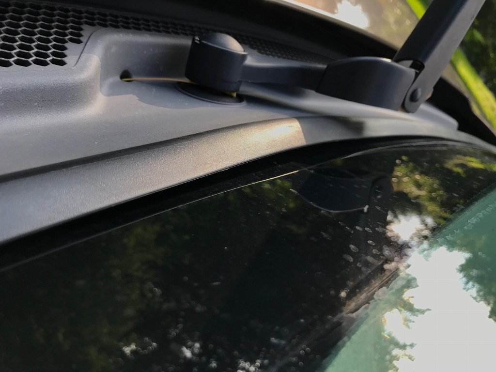

So, sure enough, this cowling thing I didn't even know aided in keeping water out of the car is buckled out quiet a bit in the center and a little on each end.
Is this (pic below) likely my issue?
Is this a known design issue or due to a shoddy windshield replacement?

Maybe a little of both??? I've never seen one warped like that! I'd probably start with talking to the windshield guys and see where that goes. There's no way you can prove it wasn't warped before they changed it, but that is REALLY warped.
