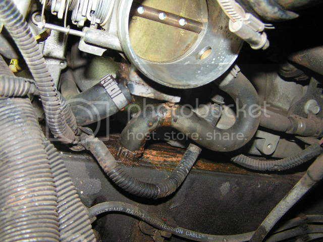

basstard440
May 12, 2006
180
Is this what your looking at? If this is your problem then it's a semi easy fix. this is the anti icer and only needs rtv.

That is if in fact the problem. I said "semi easy fix" because he will then need to bleed the system. But I agree the process was easy.

that's the problem basstard440 (except my is not as bad... :biggrin:), thanks for posting the picture.
the leak i have is from the left side of the hoses (anti icer in/outlet) base on the deposits i have around the hoses. so replace the hoses first before tackle the gasket? if yes, how do i remove those hose clamps without cutting those hoses? special tool for it?
