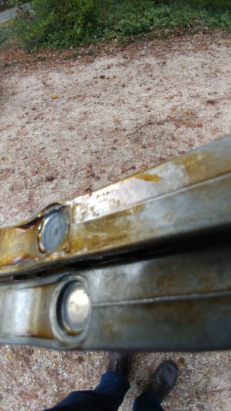

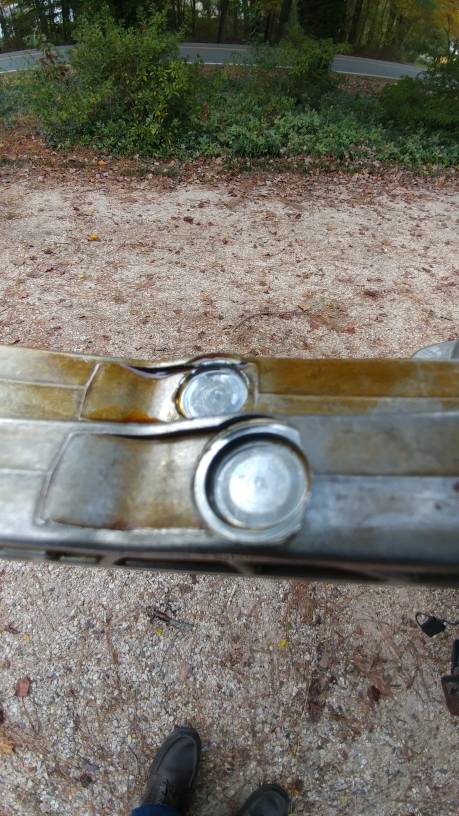

Just got mine back. No longer sounds like a diesel! Sounds great actually.
Attached are photos of the wear spots on the back of the arms. Those holes are deep...maybe an eighth of an inch. The part would have been flush originally.
All that aluminum is either in the pan or the filter hopefully. I know we would get flecks in the filter.
Tech showed me how both of the tensioners had failed. The tensioners expand and a ratchet mechanism is supposed to prevent them from retracting. Both tensioners would collapse with finger pressure.
Had in case that had a cracked off ear so that had to be replaced. Oil change and an inspection. $3400 out the door.
If you are anywhere near Richmond va I would recommend David Word automotive.
