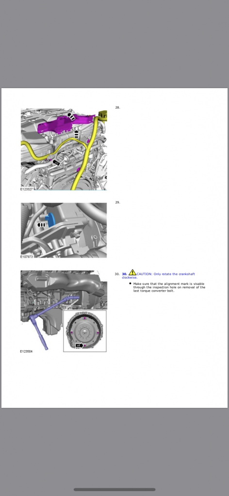

Sh17!!!!!! Those jackasses moved the torque converter access from behind the starter (on LR3) to behind the freaking differential on the LR4. Differential removal required just to access torque converter bolts!!!!! I’m tapping out! It’s going back together and I’m paying my guy $1000 to do it. Stupid to not... she’s going back together boys. Sorry to disappoint

Friggin crazy. In the workshop manual it references removing the differential and I kind of ignored it thinking it unnecessary. Then I was looking for the access hole above the starter and it hit me- and I started looking at the manual again- and sure as $hi7, they moved the damn thing to the other side above the friggin diff! British bastards!
If you are reading this, and plan to replace the transmission, body off is the way to go. I don’t have a lift and didn’t want to get into it that way, but would have likely been way easier!
See WSM- drivers side access to converter bolts!
Had it in my head from LR3 video I watched that the access would be above the starter motor. Devil is in the details.
Just before I hit this issue, I was thinking “this is not that terrible”, involved but not terrible. I take it all back!!!!
