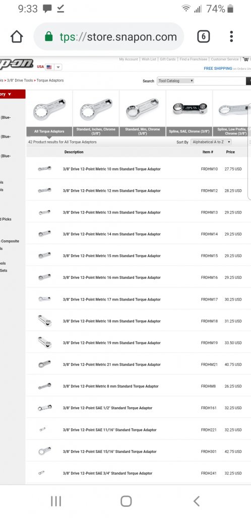

$29ish if I am looking at the right item from Snap-on.
ETA:. You know Rover $hit is overpriced if Snap-On is 40% of the cost. LOL.
Thanks! Ordered. Nothing on amazon that matched unless a full set. Just needed the 13mm. I can stomach $30 for this. Thanks for sending that over.

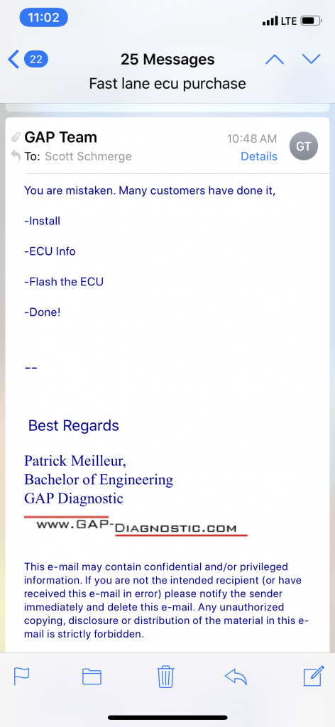

I’m talking with GAP IID now and they are saying it can be reflashed to the truck. It does require to be programmed to the vehicle, I know that much.
I heard from someone else that they are single use. I’m leaning with trusting GAP team advice, but man am I going to be frustrated if they are wrong (as I will be 95% of the way there when I do the bridge seal and sleeves under the mechatronic).
My concern is if my old TCM is faulty and causing the issue, I’ll be equally as frustrated...

From the horses mouth.
