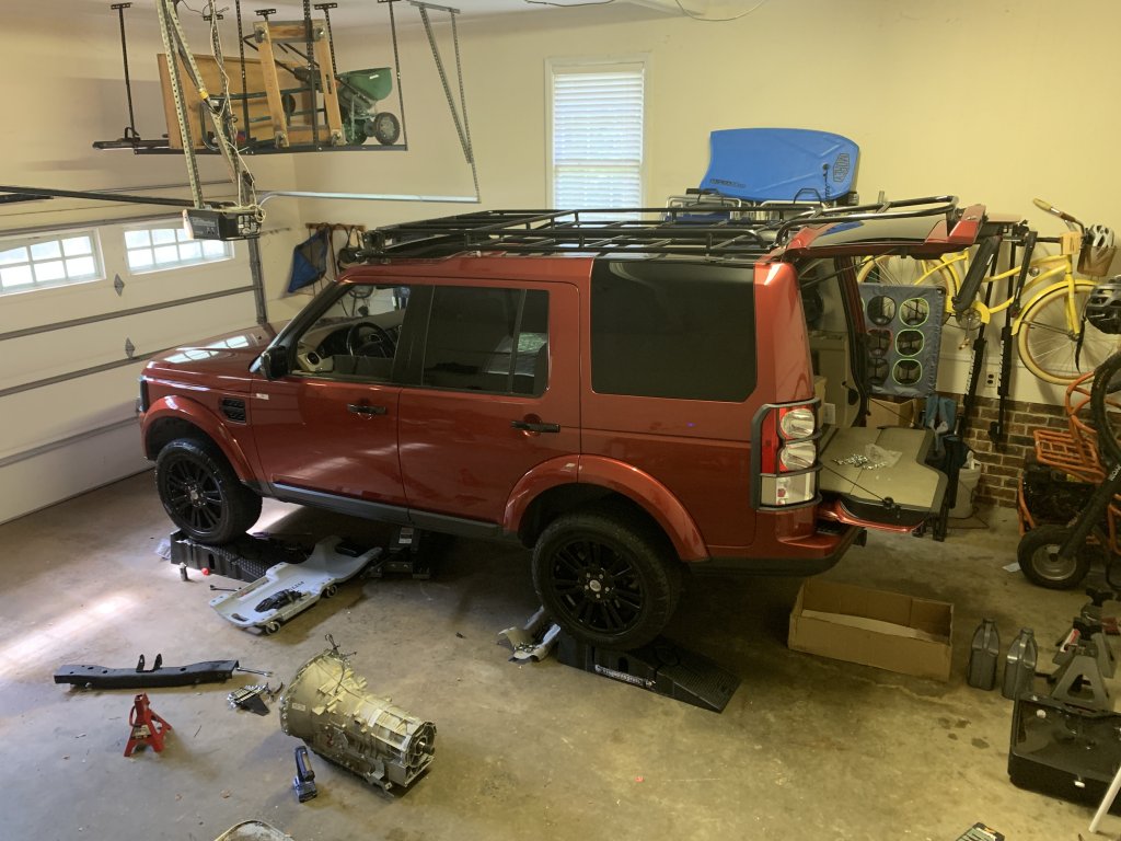

Alright, so had a bit of time this am, have almost everything removed except transfer case and transmission.
No major headaches getting stuff out. Trying to video document everything.
Removed exhaust
Removed crossmember
Removed drivelines
Now to remove starter
Unbolt torque converter
Remove Transfer case
Remove transmission
Access is tight for transfer case so may loosen transmission and tilt down for access to remove transfer case

Trans-plant surgery underway

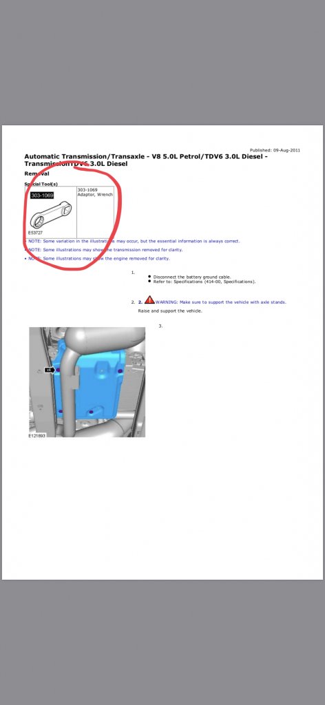

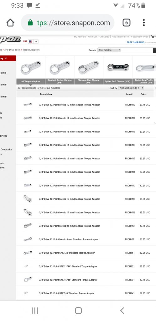

Not for the faint of heart, that’s for sure!!!! Hit my first snag. There’s a 13mm adapter in the manual- this is an extension to get enough leverage on the transfer case to transmission bolts (assuming transmission as well). About 3.5 hours so far on removal.
