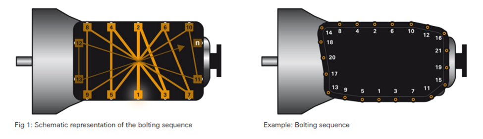

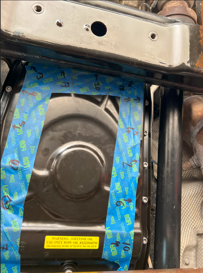

Here is a picture of the pan in place with the bolt sequence on the painters tape...
Here's the bolt torque sequence:

Good call on the tape. For us novices it really helps to write stuff down. When I was doing the valve covers on my project I wrote on the valve cover in sharpie.
