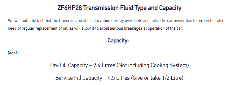

Thanks, yep fluid only at the moment, if I have to do it again then so be it, the fluid will only get "cleaner" as a result. I will take the pan off hence the pictures. How much fluid do I need, is it the 7L per British Atlantic, I suspect it is per one of the ZF manuals I found:
I'm still doing research!

I am always worried about going under the car without jackstands, especially with it turned on - what if the EAS system detects an issue and drops it to the bump stops? I would suggest extended height, with jackstands just to make sure it can't fall on you while you're underneath. I can't imagine getting it into 6th gear while on stands, you'd certainly want the wheels off or you'd have a risky situation with those heavy wheels spinning at highway speeds.
So my recommendation would be:
- extended height
- jack stands for safety
- RNDNRP for gears, once in "normal mode" and once in "winter/gravel" mode just to get 1st and 2nd going. I have no basis for this other than it can't hurt.
- fluid/pan/filter
When I had ours done, it shifted so much better just with the fluid/filter change. They did do the seal for the wires going into the transmission, but don't think they touched the mechatronic otherwise.
