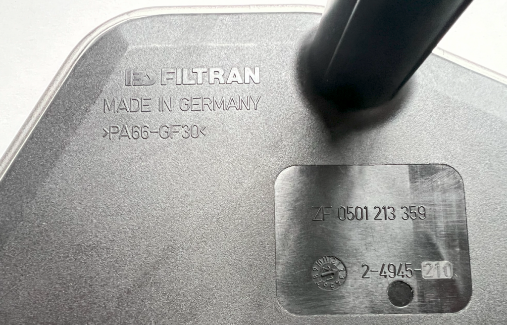

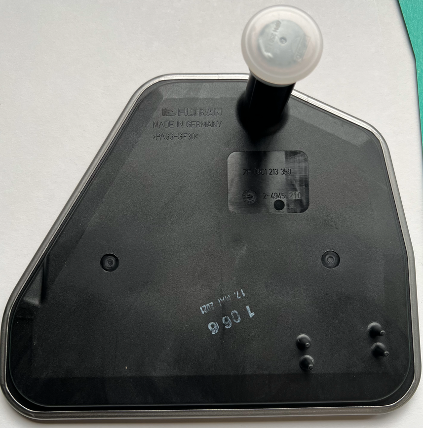

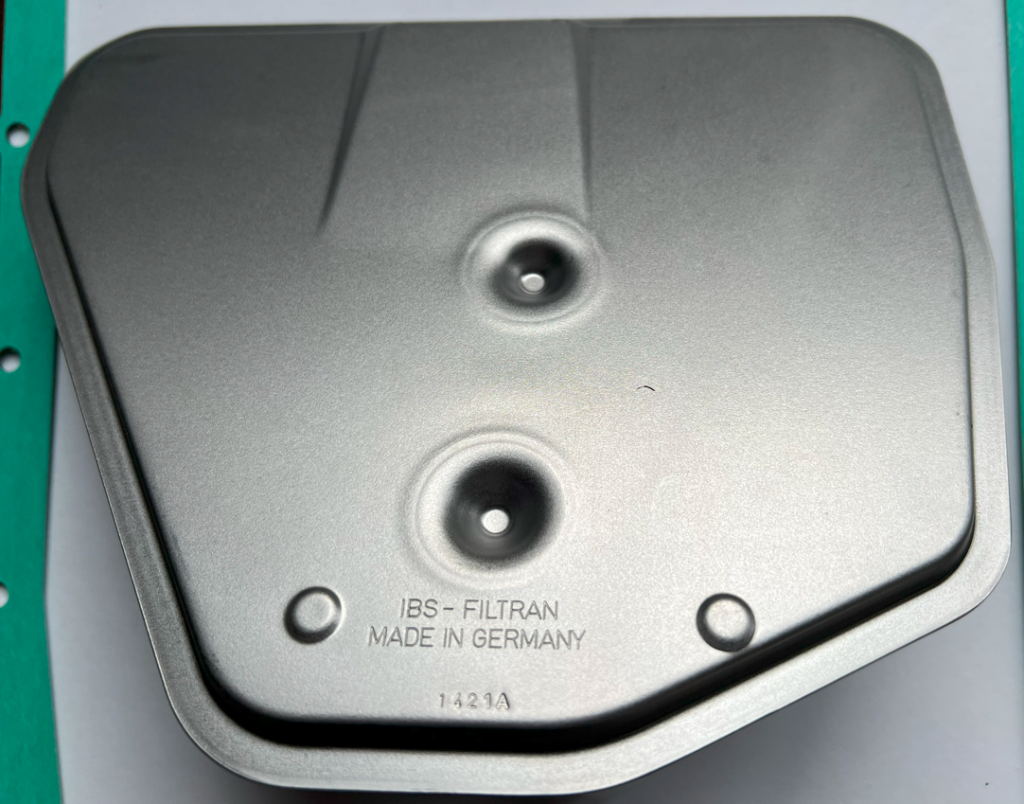

Here are some up close photos of the transmission filter, the ZF stamping is clear to see:

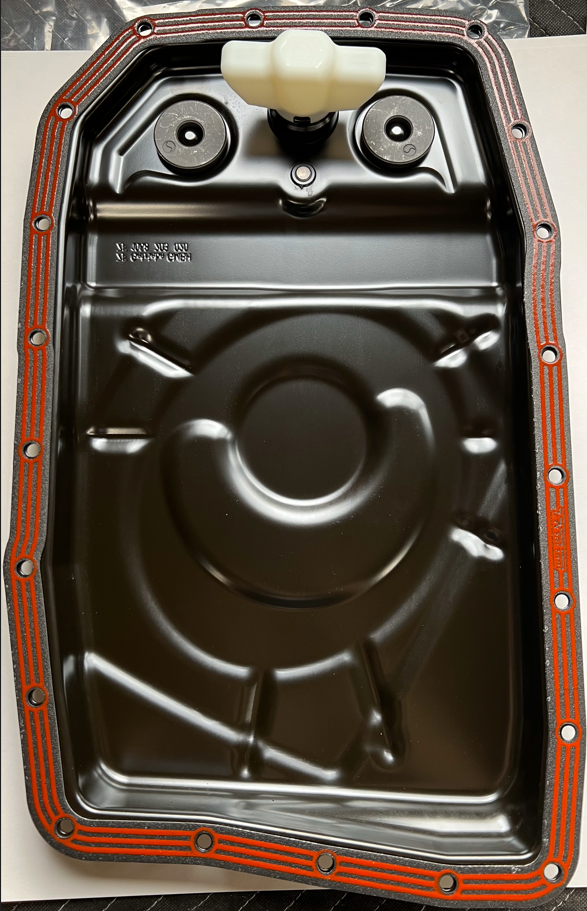

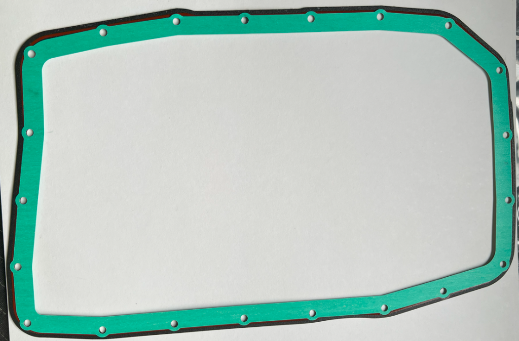

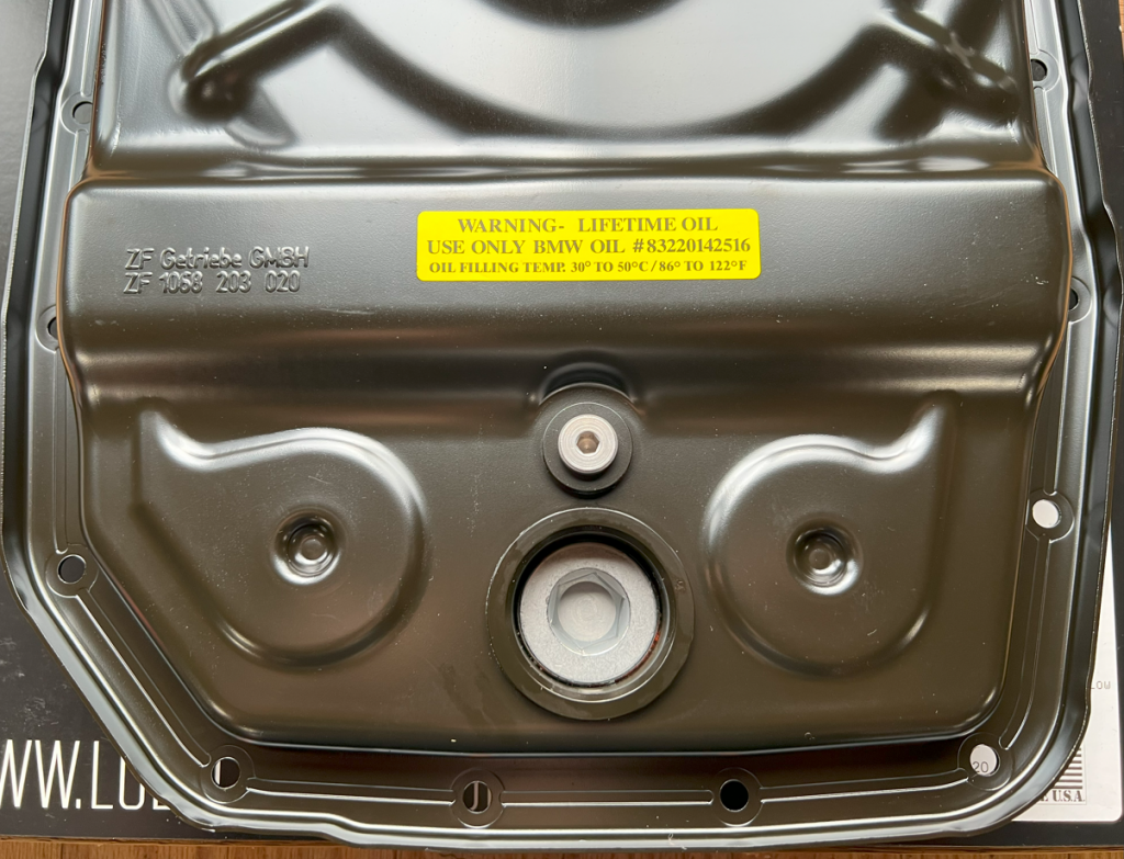

Here is an overlay of the paper gasket over the LubeLocker gasket:
LubeLocker on it's own:
The LubeLocker positioned on the pan:
