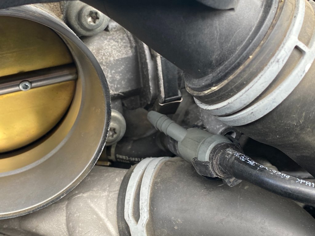

So I did get it off, but no markings at all that I can see on the supercharger belt. And THEN...
I see what's in the image here. There's a coolant Y sitting right next to the throttle body, and I guess it must be plugged because coolant isn't coming out. But why the heck would this be here?

I noticed mine had the same barb that wasn't being used when I had everything off the other day. The other part of the "Y" connects under the throttle body.
