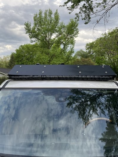

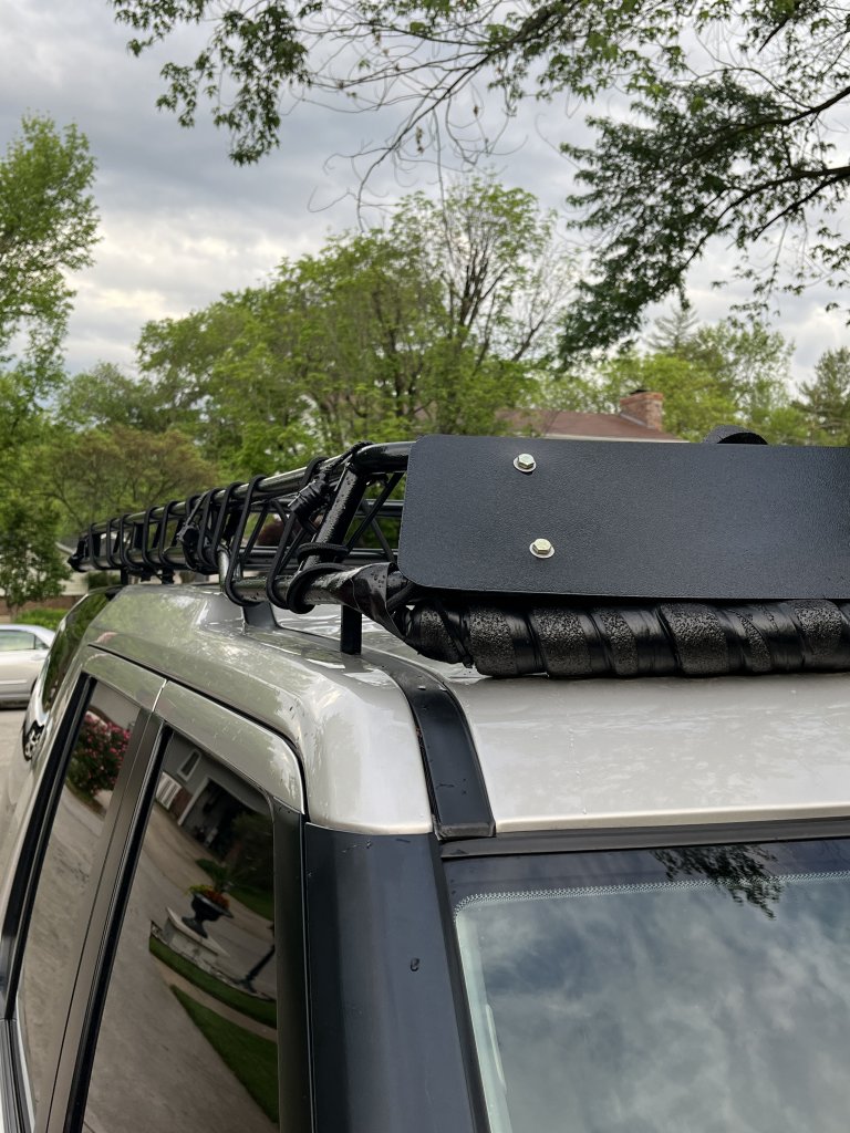

I have a voyager slim line with a wind faring. The noise was obnoxious. Easy fix is a pool noodle wedged between wind faring and roof of vehicle. Another trick is to wrap binge cords around the bars to break up the wind as it passes over the bars

I bought the slimline full length and paid extra for the fiberglass wrap-around faring and the wind noise went down considerably from the stock sheet metal faring. I also did the pool noodle trick. So far... so good...
