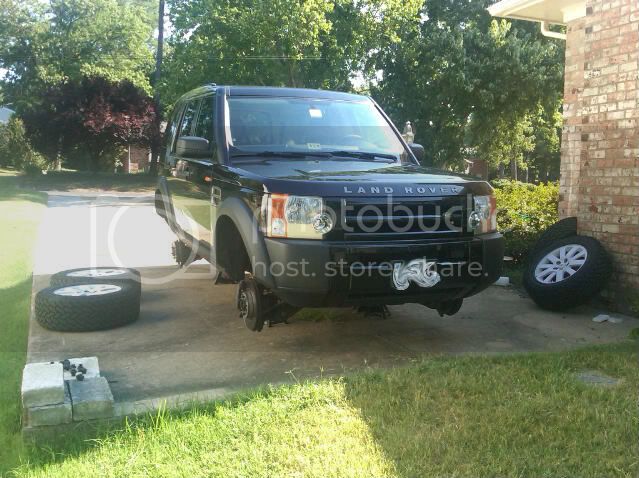

Here is a pic with the vehicle on jack stands after sanding. I had to buy 2 3ton and 2 4ton jack stands, but I was happy to add them to the tool shed.

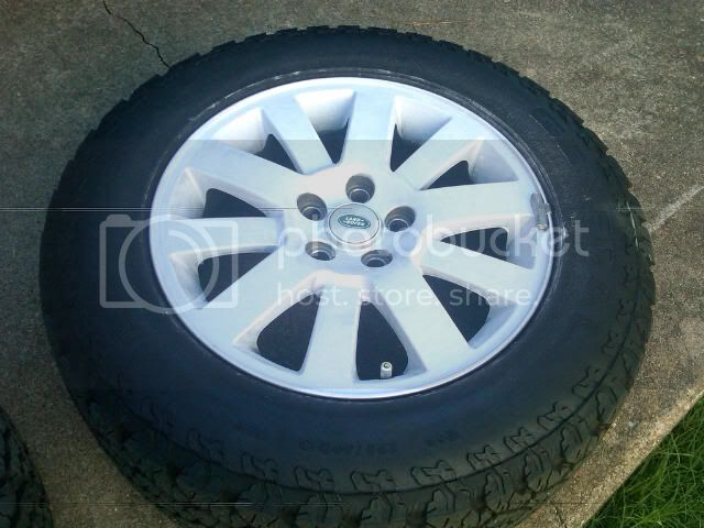

Here is a pic of the wheels after sanding, they turned white.

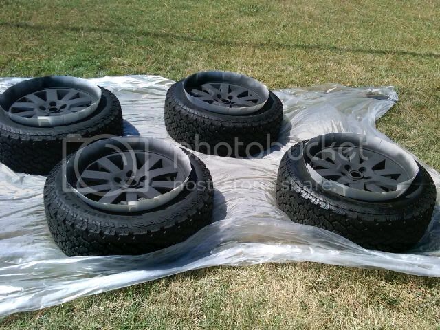

Here are the wheels after primering.
