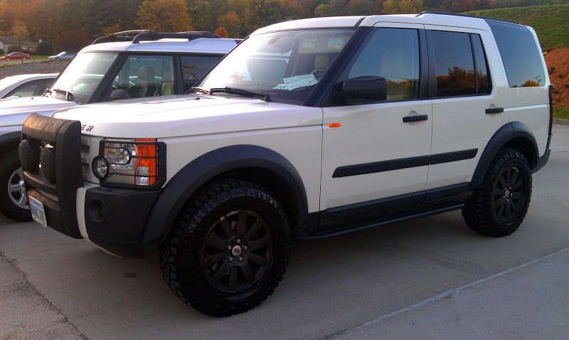

I sprayed mine in a day with the rubber still on (masked off with tape). Used this:
Still looks great over a year later. maybe one or two chunks missing, but I blame that on curbs not the paint. Ill post an updated pic with the new rubber next week.
-[edit]- sorry for the big pic, obviously it only takes 1 can to do all 5 wheels ;-)

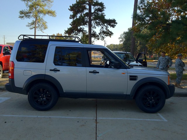

Forgot to mention the Rustoleum Mettalic is a close match to the plastic fender arches. Need some touch up to cover the old weight spots - W/ New tires:

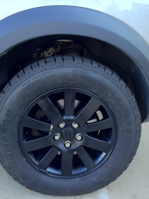

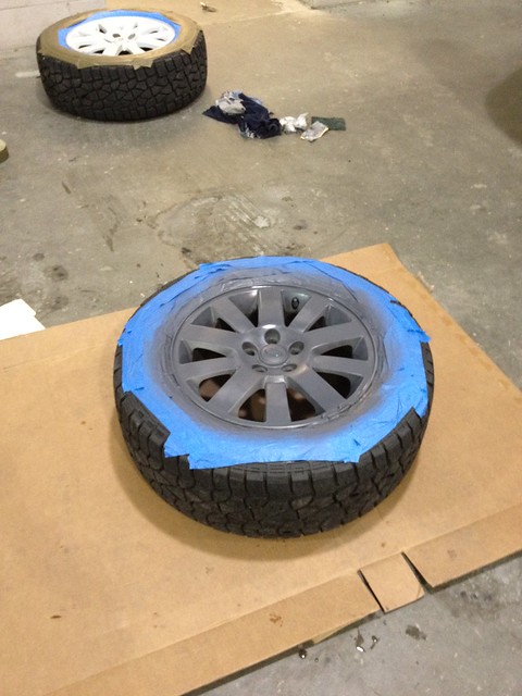

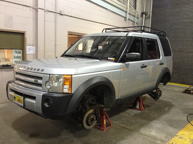

So, i did it today, all in all, they look GREAT. It took about 7 hours total with two people working. We heavy sanded the rims fixing imperfections and dings, then light sanded, cleaned and primed with a grey adhesion/ sandable primer. Then final paint color was Dupli-Color matt black wheel coating which claims to have metallic in it but i don't see it that much. Chose NOT to clear coat even though i had it, due to the fact it was adding too much gloss to my test metal that i used to see how all this would come out. I love the look, just hoping the durability will be there at least for a a few months.
Heres the pics!
