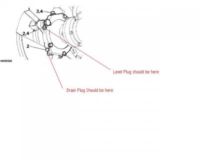

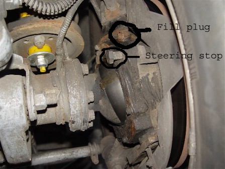

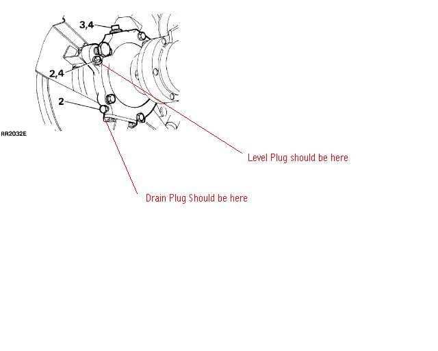

I don’t believe there is no fill or drain plug on your year of Rover. Take another look. Small box head screw in on the top and small 6 sided to drain on the bottom of the hub.
If you are facing the road from the outside IE Lug nut facing you the fill screw is at about 10 o’clock and the drain at 7. I can only think that they have been damaged or broken off.

I think I'll take a picture of the swivel housing sometime soon, and post it. I can't imagine there not being a oil level check plug or drain plug either. Maybe one of you can point it out to me. I could hardly imagine that I've missed it, though.

Here's the pic. See anything I don't?

Odd, perhaps you have an abundance of caked mud covering things...
