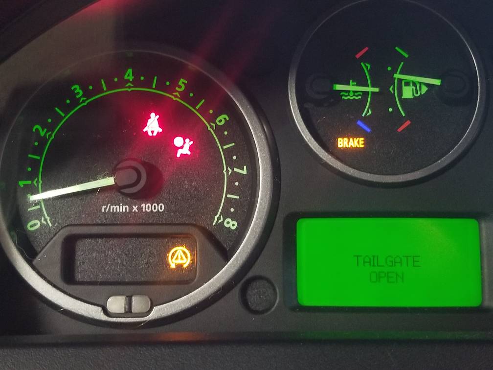

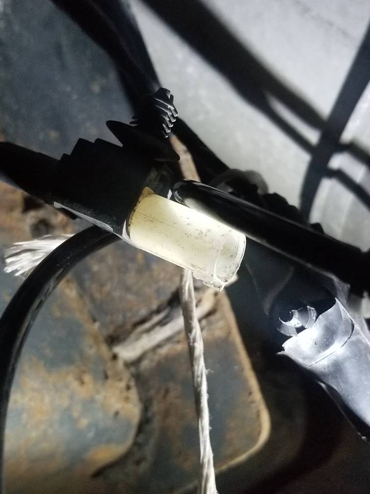

I recently have the suspension fault, the 2 roll over lights, and brake lights on. The truck wont raise at all, and during inspection i found a loose connector in the rear center of the truck right before the spare tire. But it's not the one that connects into the brake sensor but similar. Can someone please help? Pic is attached..

Need way more info....that isn't a suspension fault (pictured). What specific things are happening...does the compressor come on? Do you have any fault codes that you can read? How is your battery voltage?

I really appreciate your reply, at this point the compressor is only turning on once in a while when I start the vehicle. It wont raise at all dash shows cruise control off and a few more messages. And both roll over lights turn on. Last time I read the battery it showed 14.7

What does the dashboard information screen say when you try to raise it? What happens if you try to use a special program on Terrain Response?

Special programs not available, cruise control not available, and when I hit the button to try and raise it both arrows flash,

Okay do that, and make sure you get good quality bulbs and install them such that the filaments are vertical....and see how it goes. Wouldn't hurt to do a hard reset, either. If that doesn't work, I'd replace your Brake Switch next. Easy/cheap stuff first!
